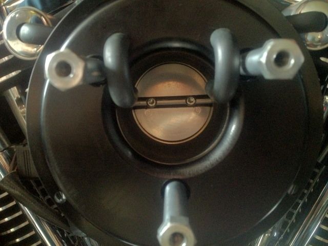

I use the fuel moto billet backing plate with some breather tubes from Vance & Hines VO2 A/C series. Hasn't leaked a single drop in 12,000 + miles; and, I don't use any oil between oil changes.

My 2008 Ultra was terrible. Before delivery I had the Stage II upgrade done at the dealer. It blew from day 1. It was so bad that it would form a puddle at the base of the cylinders. I ended up going with the Doherty Power Pacc and sent all the blow by to the ground. When I took the SE A/C off there was no evidence of blow by or oily soot on the front of the backing plate. The back side was covered. I was pretty much dissatisfied with the whole thing and never investigated further. But thinking back on it, I wonder if it could have been improperly sized O-rings, or the mating surfaces not being flat enough for the O-rings to properly seal. When you get the dealer's B/S answer that they all do that and you know they don't, makes you wonder if it is really a defect. You might want to try fatter O-rings.
The Doherty was an expensive way to go. The Fuel Moto worked great the way it was and was priced right; but, I didn't want to take any chances and went with the different breather hoses. Jamie guaranteed me that his billet A/C would not leak or my money back. If at some point I decide to vent to the atmosphere I can do it without much hassle.
