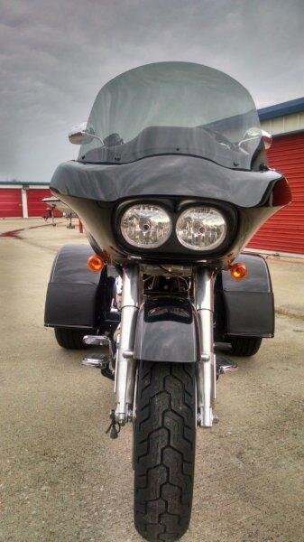

after reading all the comments on this forum and talking with the Dunlop Tech guy's I went with the Dunlop 402 MU85B16. Really happy with the ride and handling. It fills out the fender real well
