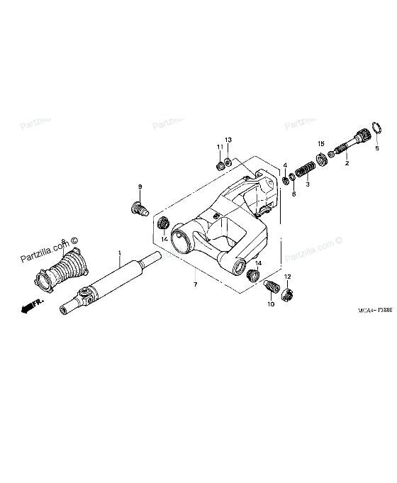

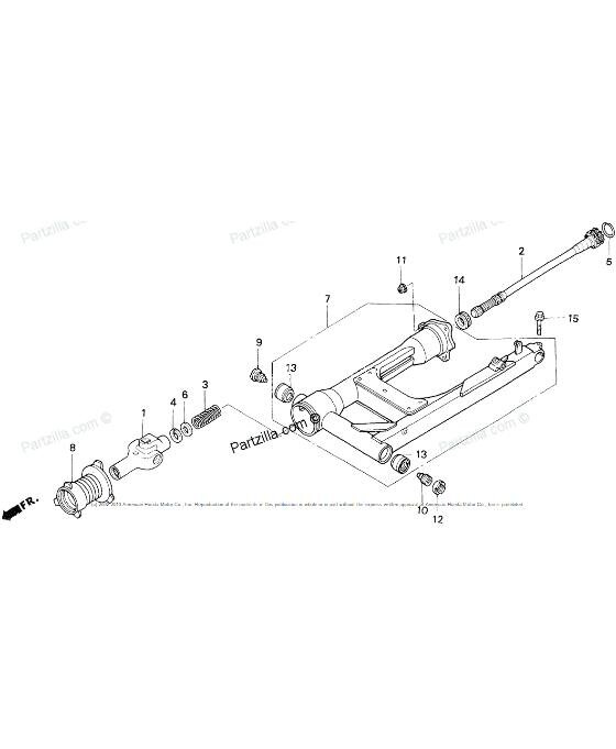

Please clearify. If you are saying these two drive shafts in the pictures are the same, then I'm afraid you are passing out misleading information. If I am wrong, I stand corrected.. In this case pictures do not lie. :cxtv: :cxtv:
2000 GL1500 swing arm assembly..
2001 GL1800 swing arm assembly....

OK. Now I see the confusion. What you had was one of the original Motor Trike drive shafts which was actually a modified GL1500 shaft. That is how your dealer was able to take an off the shelf front yoke and get you going. That same yoke would not fit on a true Motor Trike drive shaft.
