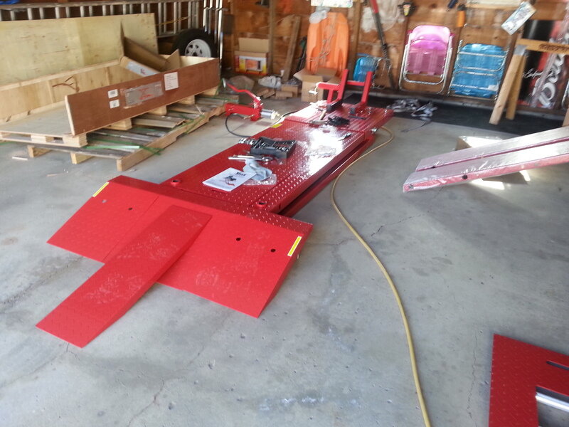

My lift table is a K & L MC655R. I had an opportunity to buy a four year old professional optioned unit from a trike builder that was retiring. Could not pass that opportunity up. Absolutely love this lift table. I also have a lift I used back in my two wheel days to lift the GL1800 from the center of balance point. It works on some trike rear frames but usually in those situations I just use the low clearance/quick pump floor jack and jack stands. :xszpv: :xszpv:

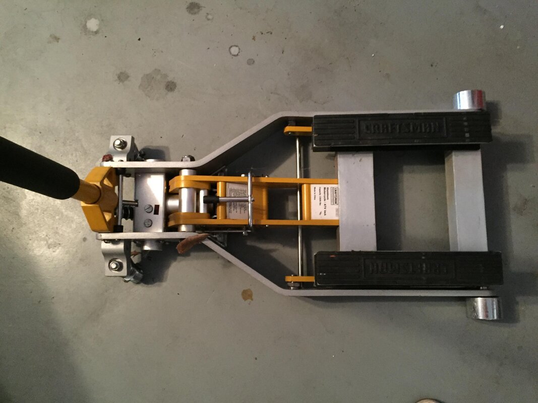

It has been modified by me,i took all the specs to a engineer at work and told him what i wanted to do and he said it will work fine,I made up some 1/8 thick steel pans 1 1/2 x 14 x 14,and the lift had a hole at the rear of the table on both sides that was 1 3/8 in dia.I bought a piece of black gas pipe 1 5/16 in dia at Lowes that was just slightly shorter the the combined width of the lift and pans.
Then i drilled a 1 5/16 hole in both pans on one side only that would line up with the holes in the lift.Then drilling 4, 3/8 mounting holes i mounted one pan slid the pipe thru the lift and into the pan then slid the other pan on and mounted it so now the pipe cant be removed unless you pull one pan off.It ended up with the pipe almost dead center of the rear wheels.It lifted my buddies trike like it was nothing.as soon as i can figure out why i can download pics from my phone to my computer i will post so e pics.
