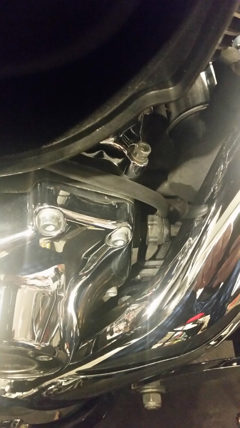

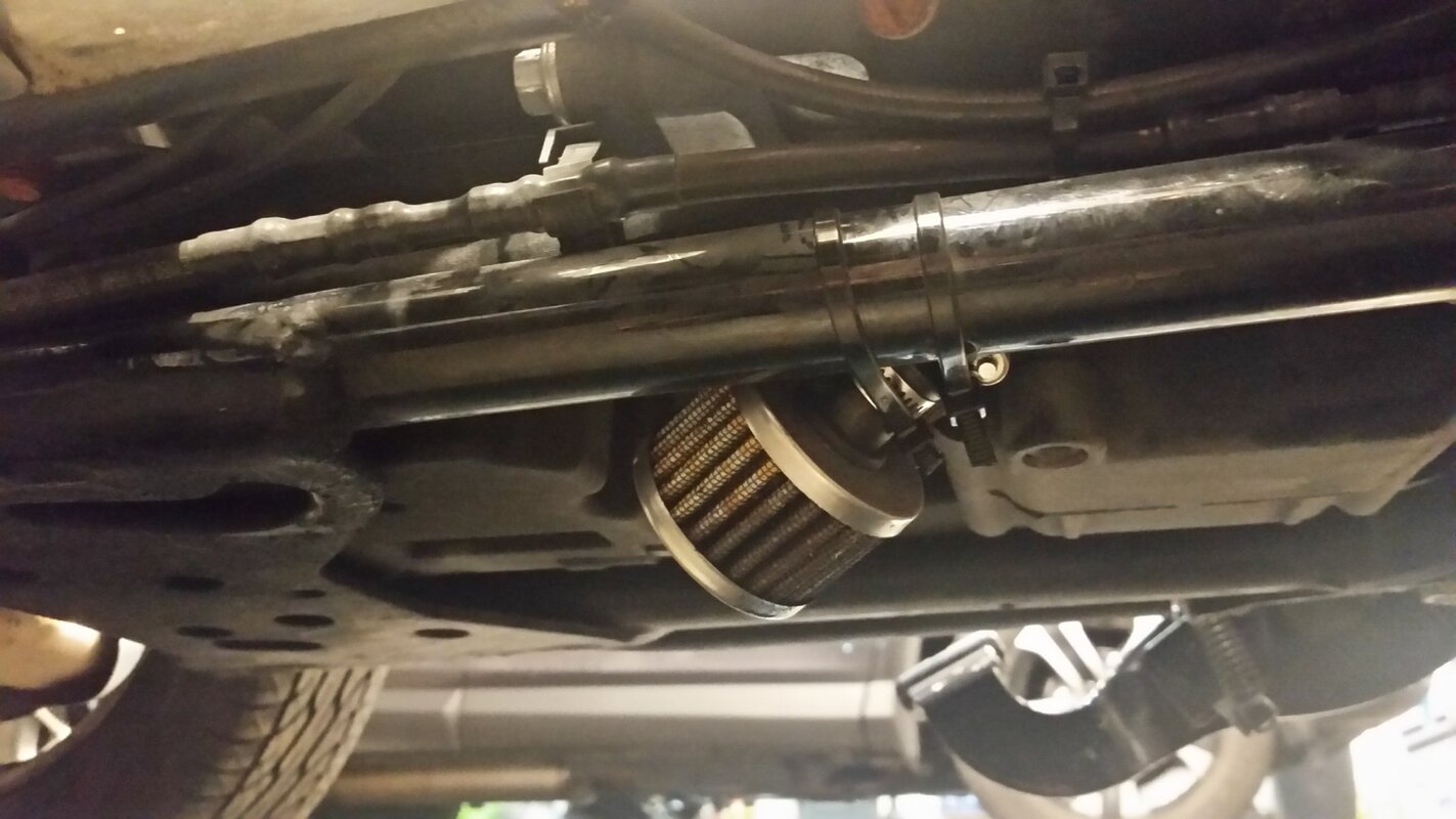

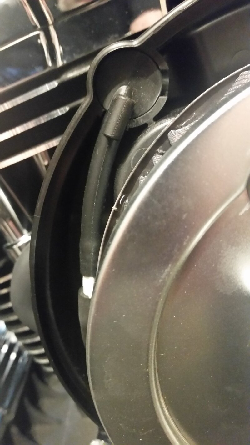

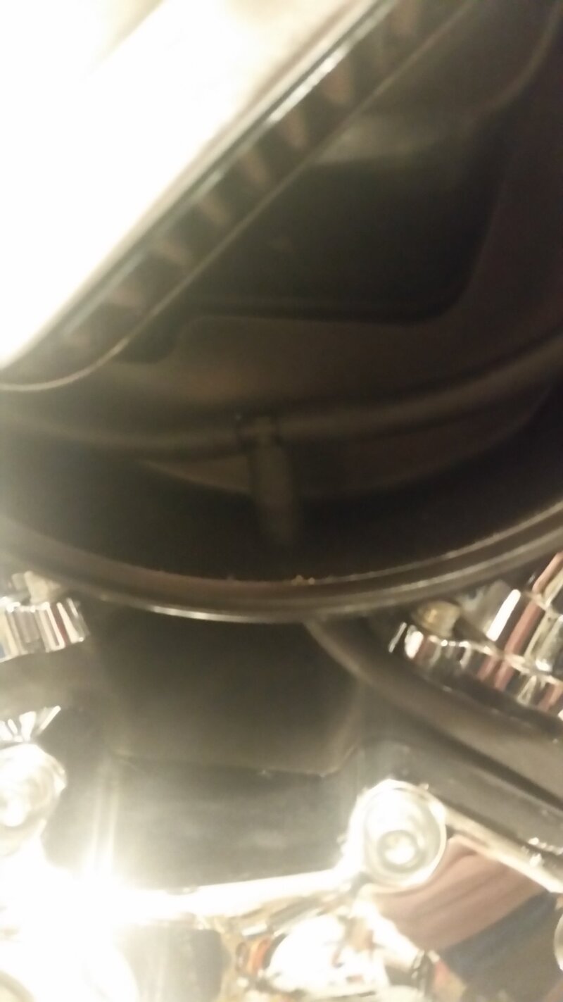

I also put in a k&n. Because i have an extended warranty and really don't trust moco, i bought a backing plate and breather hose, then notched the backing plate at the breathers at six o'clock so the breather hose set in tight after i disconnected it at the t. Drilled a hole in the backing plate at five o'clock, and connected ebs. Ran hose to front of trike, away from heat sources and mounted filter on right frame rail about 1 foot in front of oil pan. If i have to get warranty work done i can put the original parts back on.

EBS pics
I'll pull off the air cleaner tomorrow and get some pictures.

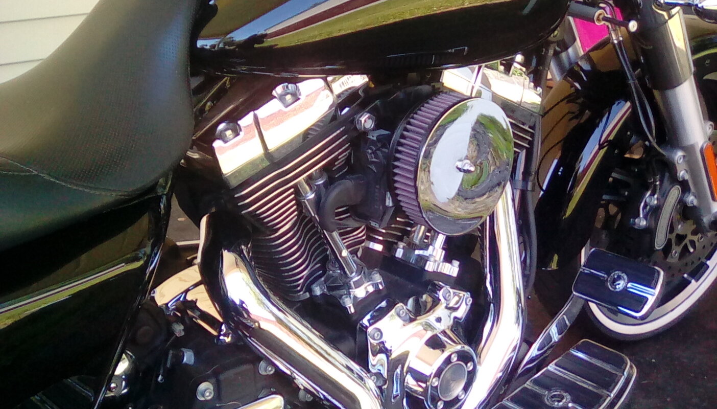

IMG_20190625_110116.jpgI did a 30 mile test run, there was a smell of oil and an oily mist was on the leading edge of the side cover, neither one was that bad. The bike did run stronger I believe, and more responsive. I'm pretty much satisfied, going to go with this setup unless forced to change it.
Install complete, kind of small but look okay. I haven't had time to test ride it yet. EBS, VIED, V&H straight shots leaves me curious how it's going to run.

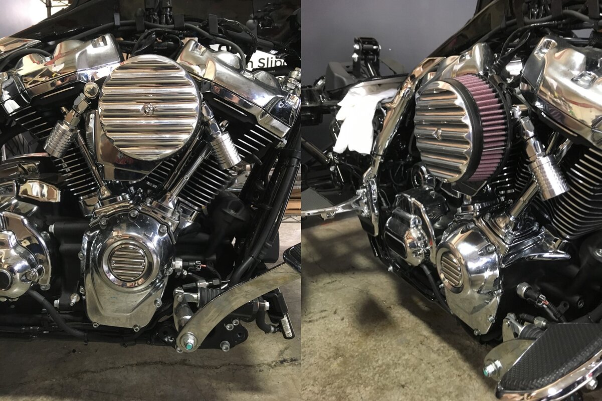

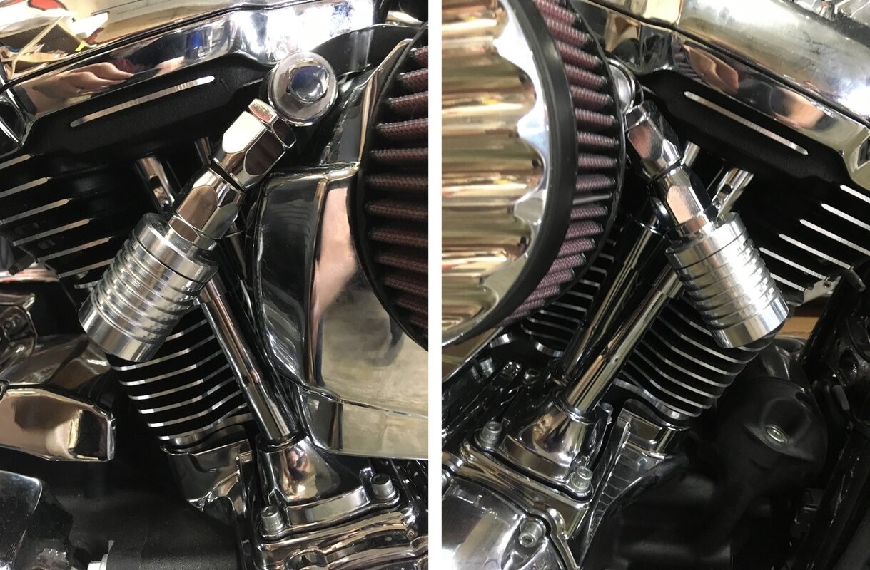

I went for a little different installation. The M8 is not like the Twin Cam as far as hose routing options were concerned. So I got two cans and tied tem directly to the breather bolts. Since cylinders are call "jugs" I guess these can be called nipples :D
Still gotta tighten them up a little, but waiting until final assembly to final install everything. Perky little devils eh Kevin?

Very cool EBS Jeff, Where did you score this set up?
Sorry for the delayed reply Jack...
I made it from DK parts. The one can install caused me to have to route the hose in ways that I did not like as it looked bad (like an afterthought). Kevin has a nice picture of a twin cam with twin cans on his web site and I adapted that concept to the M8. Use the breather bolts that come with the kit. A pair of short lines. 4 hose clamp covers and two cans... and there she is.
One change since the photos is to go with braided steel line, even thought it does not show. It is stiffer than the hose and straightens out the line on them so they look almost like the factory put them on.
