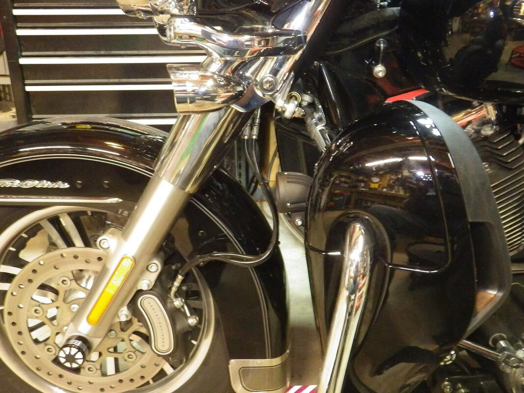

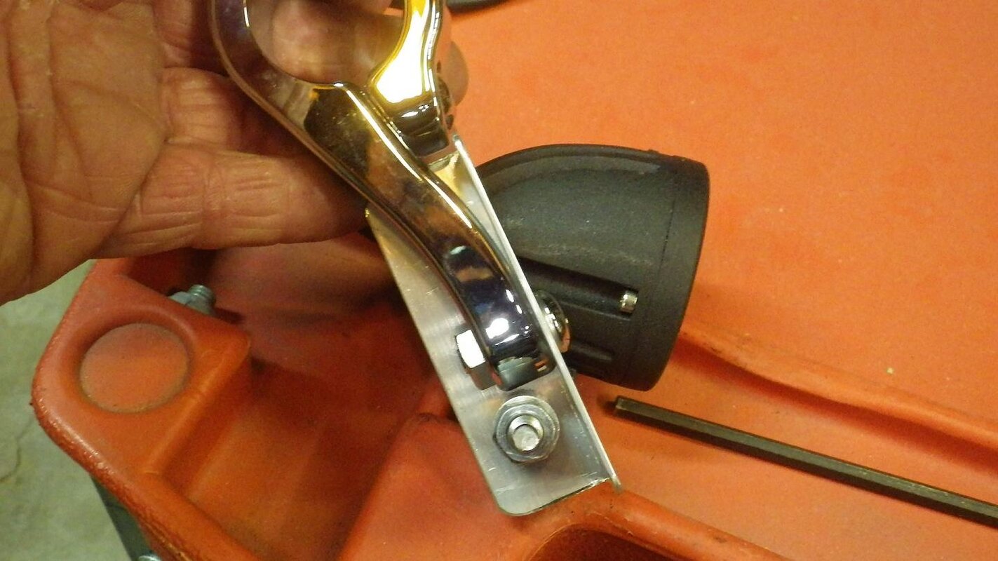

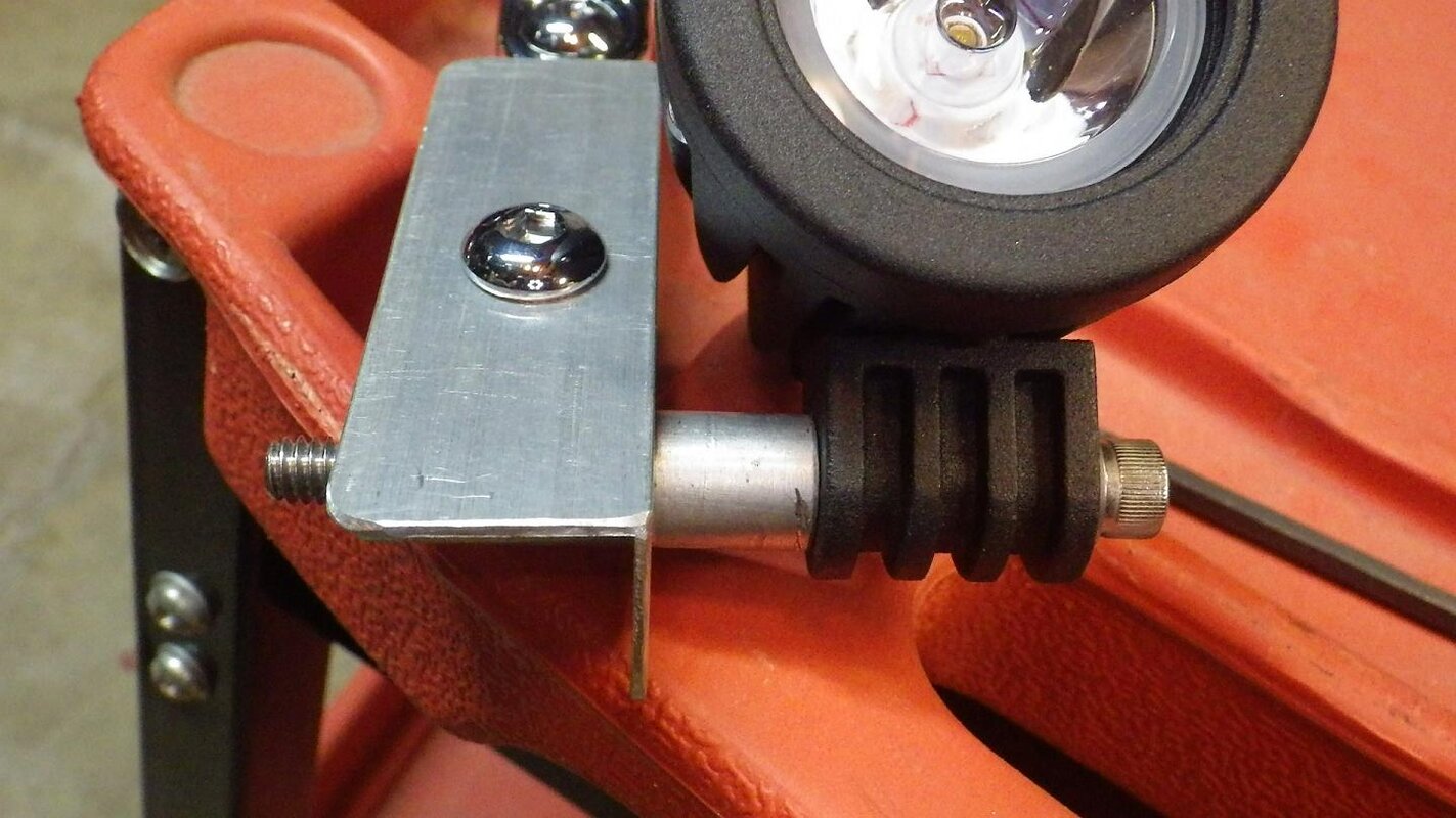

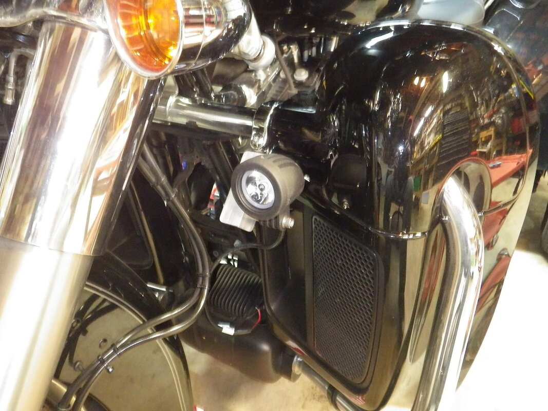

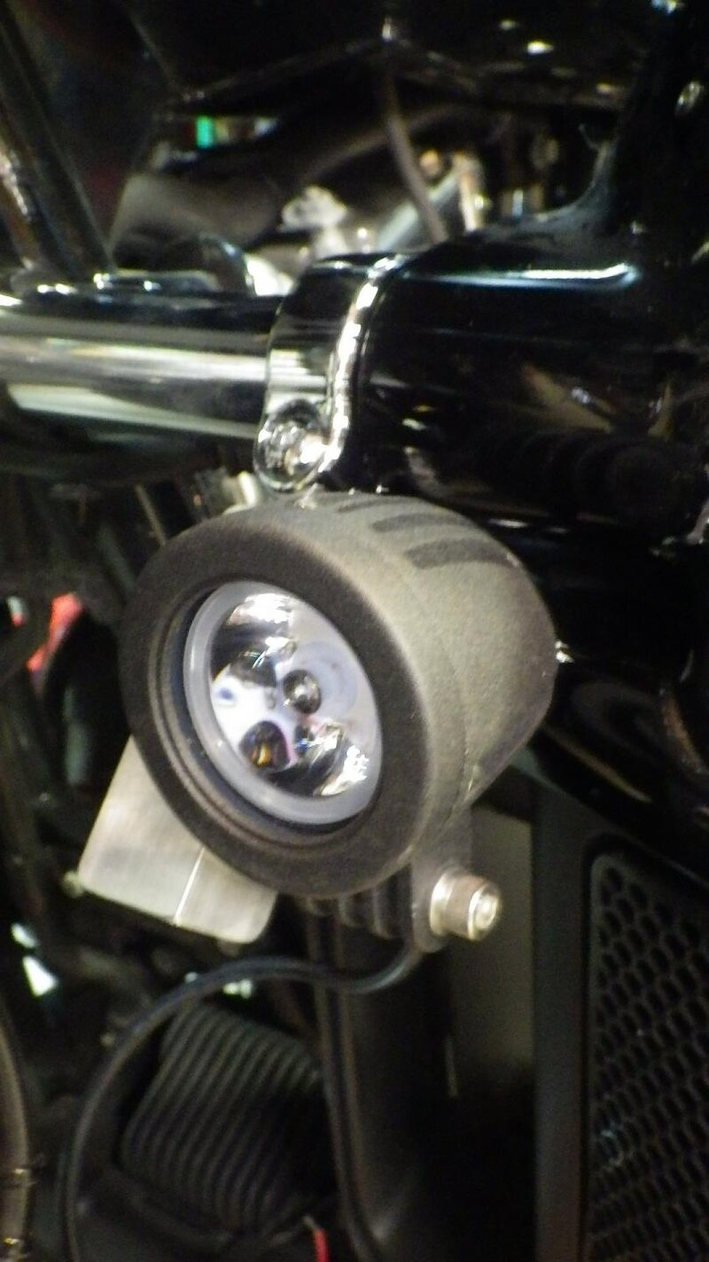

I took advantage of this sale and got a set of the Stealth Driving Lights today along with a set of the black <b>L</b> brackets. But I like to be different, so after sitting and looking at it for a while I decided to try and mount them off the top of the engine protection bar just in front of the radiators. <br />
<br />
So I went and got a set of HD LED Fog Lamp Engine Guard Clamps in chrome, and made me a moc-up bracket out of 1" x 1" x 1/16" angle aluminum. Once I am satisfied with the design I will make a more refined bracket out of 1" x 1" x 1/8" angle aluminum and maybe paint it black for that <b><i>Stealthy</i></b> look.<br />
<br />
<font color="silver"><font size="1">- - - Updated - - -</font></font><br />
<br />
Here is one more (lousy pic) from the front and to show its location in relationship to the other lights.

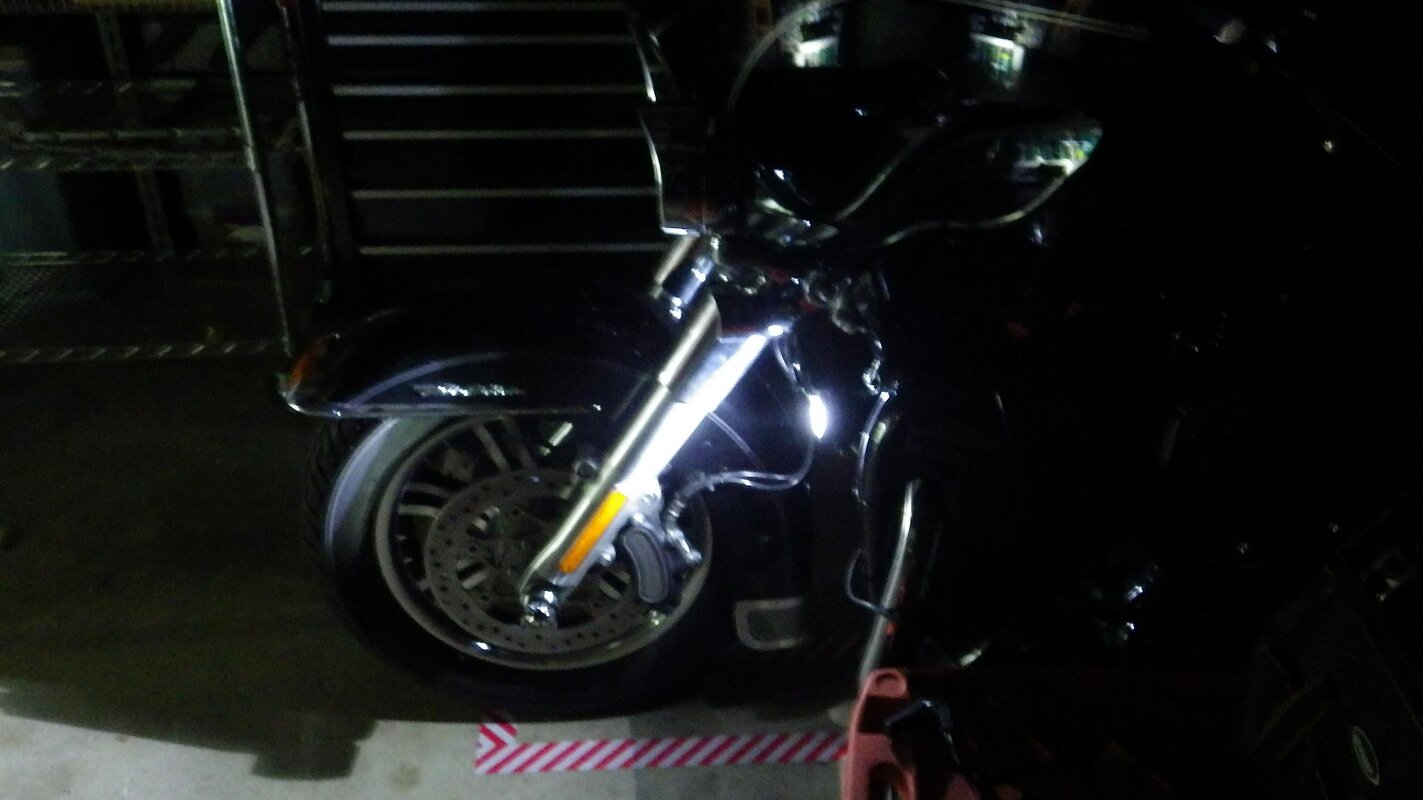

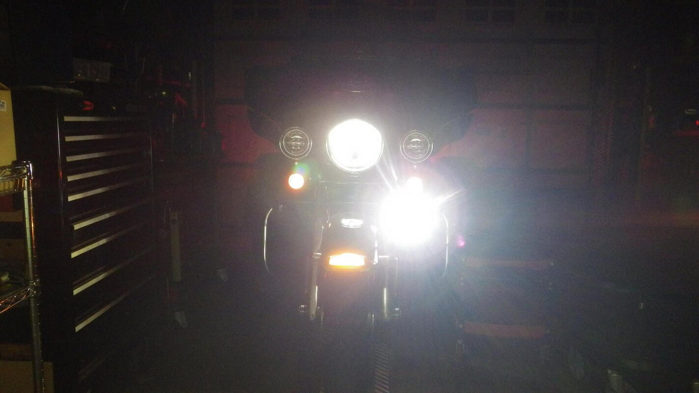

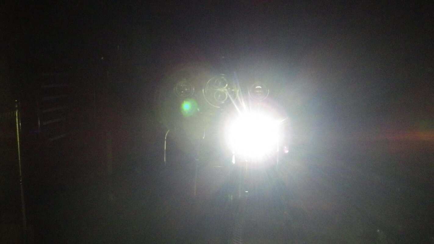

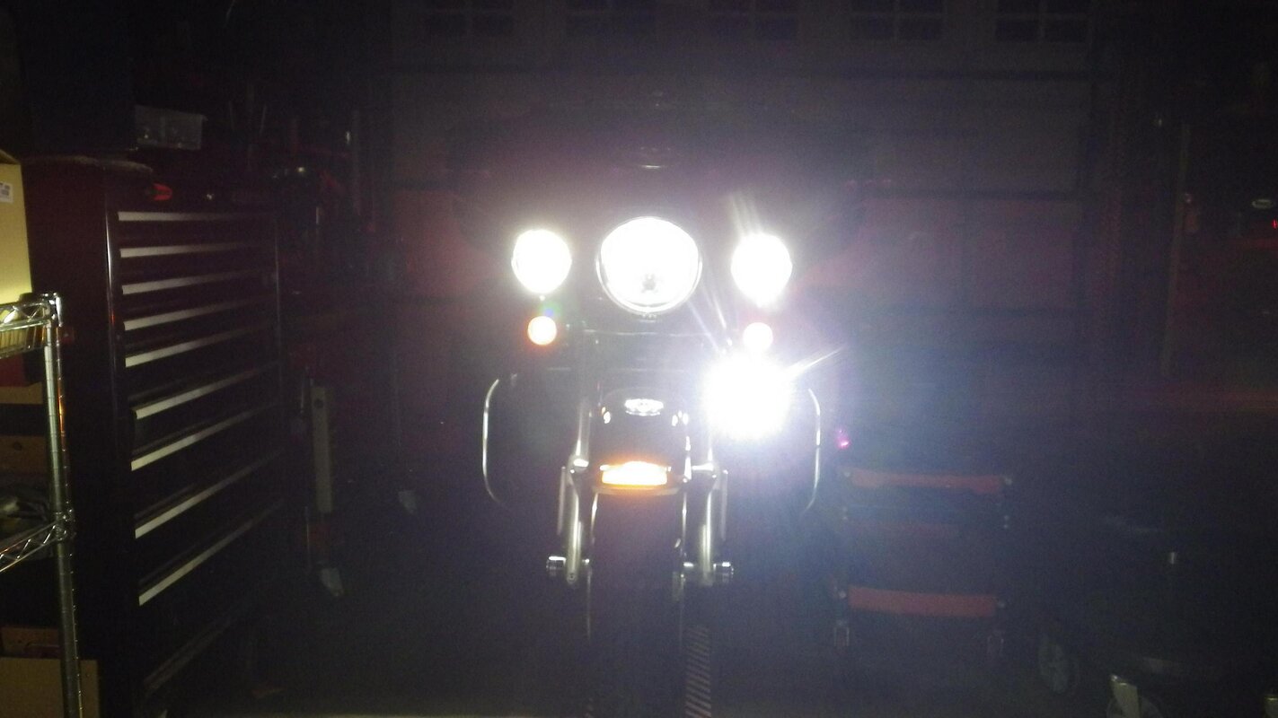

For me, wiring these up is going to be more of a challenge than finding a good place and way to mount them. But I really wanted to see how they will light up the night, or at least my garage. So I hooked it up to my MicroStart XP-! Antigravity battery and power supply. The last shot is from the side with just the Stealth light on. These little buggers are pretty danged <b>BRIGHT!</b>​
