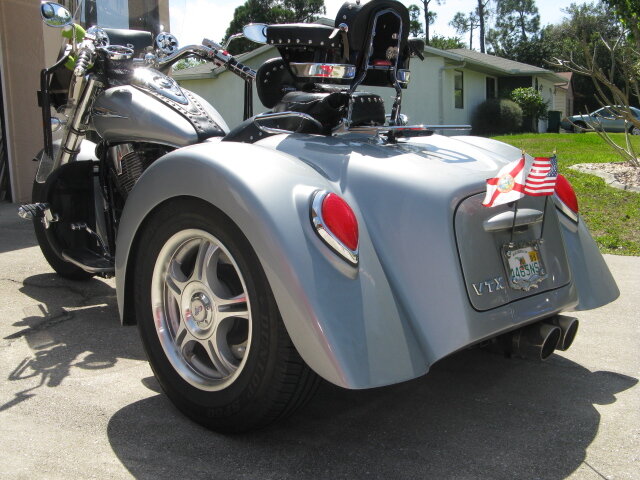

Run your air pressure to 40/41 LBS. There are 100's of folks running them. You are the first complaint I have read that didn't like them. I read many pages on tires before I bought mine. I have 7,000 miles on mine and it looks like the day I put it on. Rear tire on front mounted in reverse. Lots of folks reporting 30,000 miles! No signs of cupping. Did you have it Balanced? Weights or beads?
