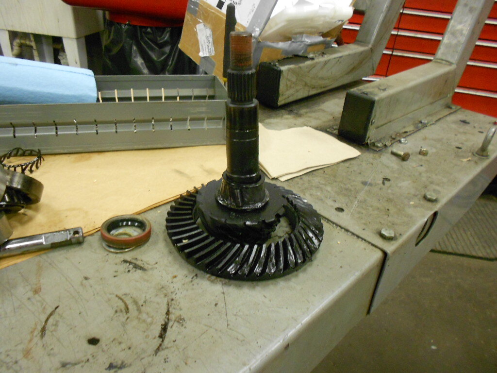

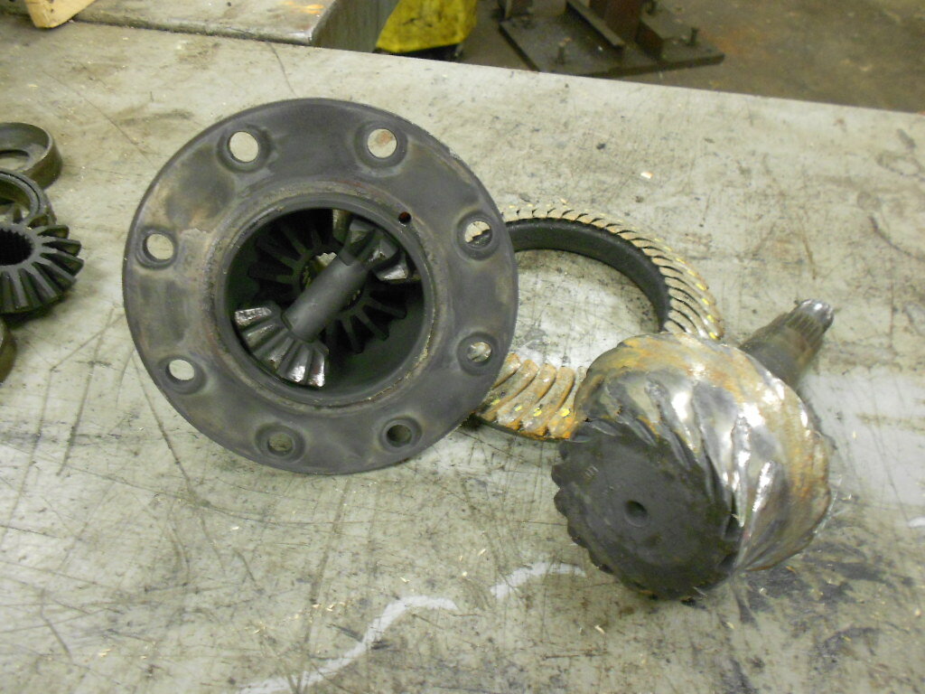

Mick, Don't let it run low.................
Here are 2 examples of running them out of oil.
Frankly, I have never seen a pinion shaft bend at the gear or run all of the teeth off the crown and pinion.
Very expensive repair and new gear sets are becoming unavailable.
Even sawdust and oatmeal would be better than letting run dry.
