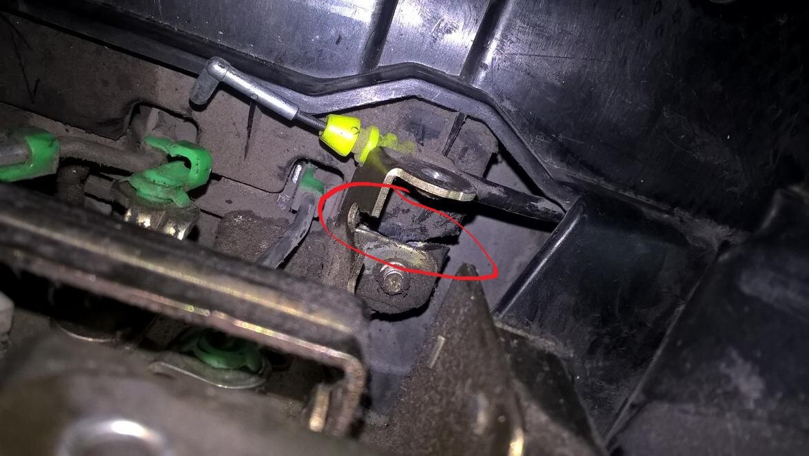

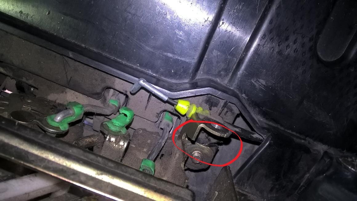

right rear mount for latch picture from front.jpgright rear mount for latch picture from back.jpgYou might want to check out where the cable comes down from inside the upper trunk. I had an issue with my 07 Lehman the same way and it turned out the cable for some odd reason came off the latch assembly in the upper trunk and the only way I could open the lower trunk was with the emergency cable.
