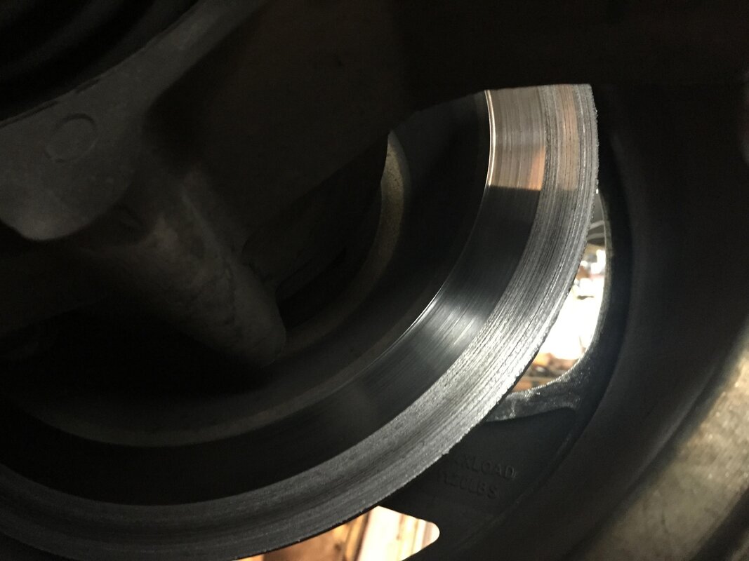

Lost an inside brake pad on one side from the sound of things. We're leaving Colorado Springs this morning, going north on 24 to 70. Planning to stop in Salina this afternoon. If anyone knows where I might find a dealer with parts, please PM me. I will need one set of standard brake pads for a 2012 GL 1800 Viper conversion.

Phil, I found a dealer in Illinois that had the pads and could work me in if we got there by three o'clock. As luck would have it, two construction areas and one wreck nixed that. Then a line of severe weather popped up between us. Since I've already toasted the rotors, we parked for the night 300 from home. We'll ease on home cautiously tomorrow. I do appreciate your offer.
Phil,
Thought I should follow up and let you know we made it home safely. Put the trike on the lift and confirmed what I thought. The left side inner pads came apart when I locked it down to avoid the deer. The CSC ABS braking system worked as advertised. Fully loaded trike & trailer headed down a steep grade, slowed from 70 mph to almost stopped without sliding. Ordered new pads and rotors last night, should have the parts on Friday.
