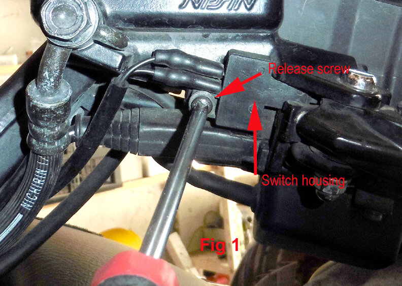

First identify the switch below the clutch leave ( Fig1.) with the screw driver identifying the screw to be undone.

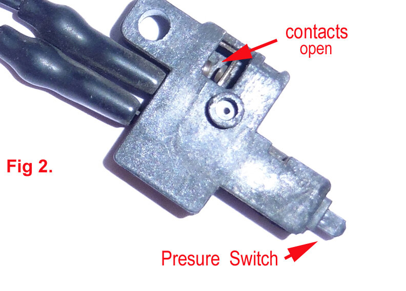

Then identify the contacts and the pressure switch (Fig2) When the pressure switch is pressed in it causes the contacts to come together thus completing a circuit. (enabling the power to allow the engine to start whilst in gear). This will only be done when the clutch lever in operated.

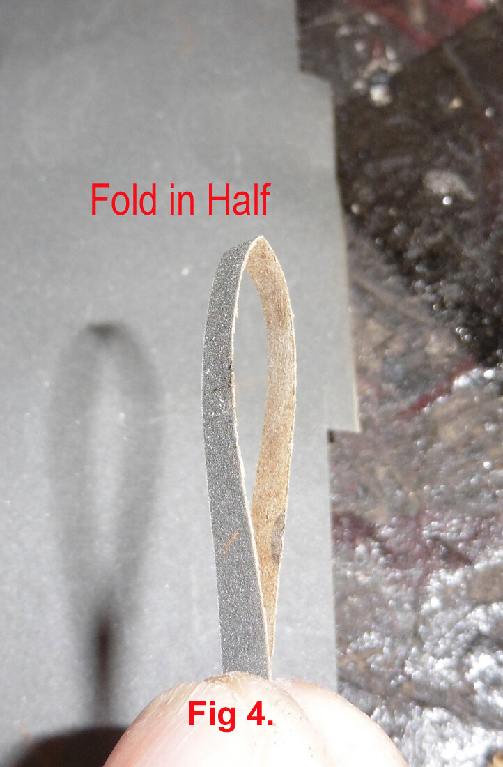

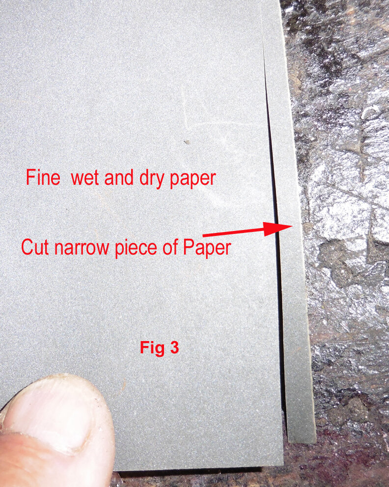

These contact can become soiled and needs to be cleaned. Do this with a narrow piece of 3000 or 5000 grit wet and dry paper (pics 3) folded to form a doubled sided fine paper file ( fig 4).

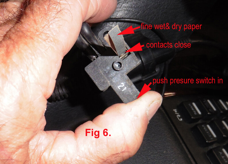

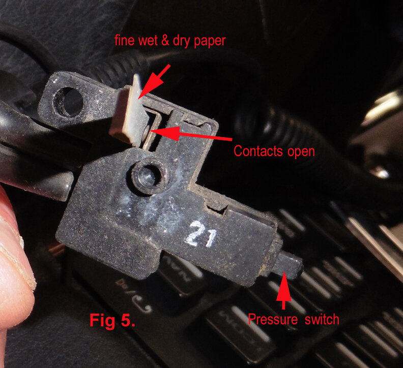

Place this in between the contacts.(Fig5).
Now press the pressure switch in.( Fig 6) allowing the contacts to come onto the paper file. Move the paper file up and down a few times and withdraw it.
