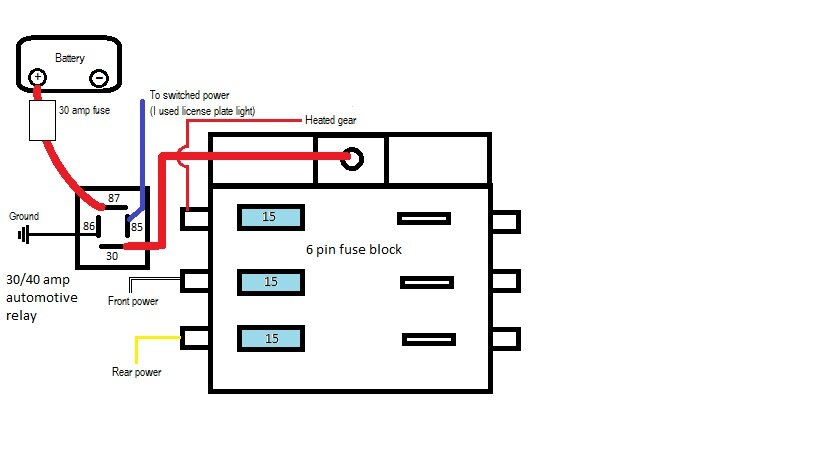

Don't know what happened to the link, so here is a diagram of the fusebox and solenoid as I put it in the Road Hawk. The diagram is the basic set up I have used in the last 7 or 8 bikes/trikes. I put it under the passenger seat in front of the rear fender (which you don't have on the Tri Glide) on my HD FLHS, under the rear seat on the 'Wing and in the front trunk on the Spyder. You can buy a distribution block for $60 or more from places like Electrical Connection, Revzilla, etc. but a fuzeblock and solenoid from the auto store or Amazon shouldn't cost you more than $20 - $25. I prefer a 6 place fuze block that has a cover on the fuses, the one on the Spyder has built in lights that come on when a fuse blows. I use 10 or 12 AWG fused wire for the power to the solenoid and fuse block, 16 AWG primary wire for everything else. I like to use a different color wire for each port, and black for the ground. You can install a ground block if you wish, but I generally find a handy frame bolt close to the port to lessen the run of wire.

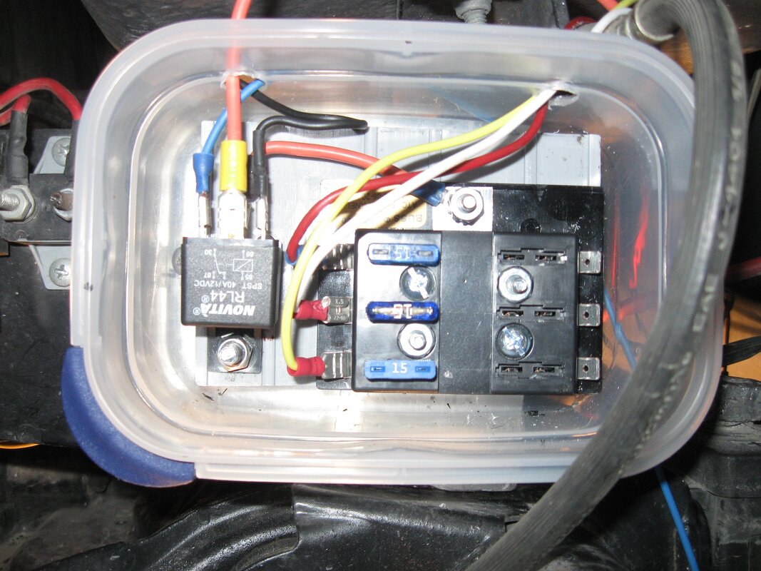

Here is a picture of the distribution block on the Road Hawk. It was very exposed under the trike next to the battery just in front of the right rear wheel. That's why I put it in the plastic box, to keep most of the road debris and wet off the block. All other rides I've put this on have been more protected and not needed to be covered.
