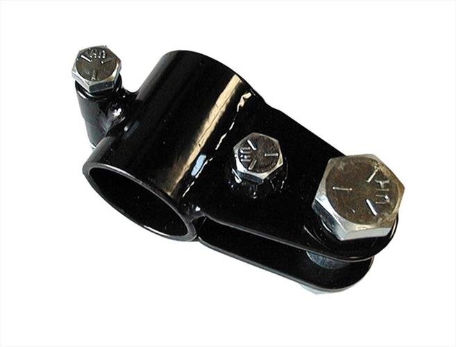

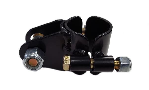

this is how we've done a few...bore out a pc of pipe weld on the bosses for the pinch slice then weld on tabs never had an issue w distorting
They both had ones to fit up to 2 or 2 1/4" round or square tubing. 41mm is just under 1 5/8". Either way, at least they might give you an idea for a solution.

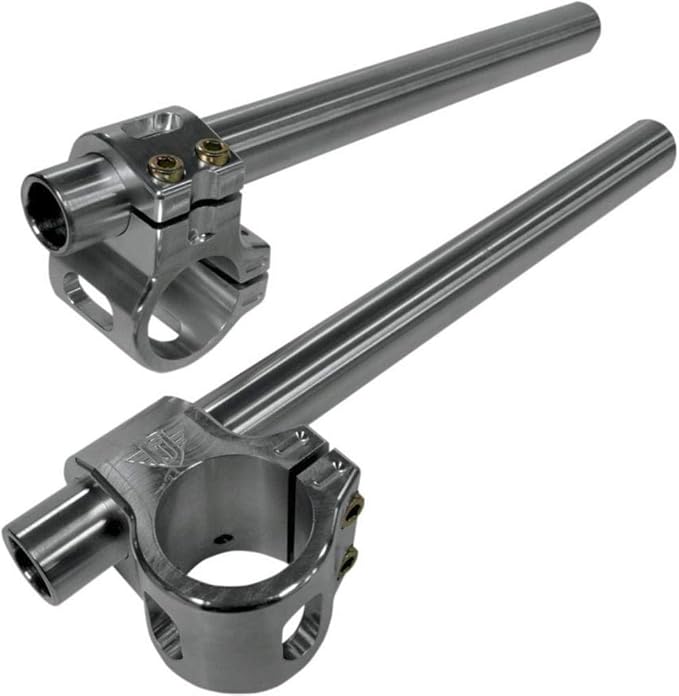

Close but no cigar??? But it does look good?
[h=1]Joker MacHine Clip on Handlebars for 41mm Fork Tubes Raw Aluminum for Harley All[/h]
Wow, I seen those and other clamp on brackets, but just now I was slapped upside the head and I see how one could have adapted such a clamp to work for what I wanted.
Where the handle bar rod goes, a shorter piece long enough to have the risers attached to it and it would have worked, but I think I will be pleased with what gets made for me.
Thank you everyone, just wish I was looking more outside the box, LOL
