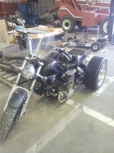

I guess this is the only pic I have with the newer pipes. All the same just made of SS and added the fin rings to the flanges.
Just to play devils advocate
Do they need to be that LOUD?
225 bucks to the judge and a moving violation
On my driving record isn't something I need

Well no. They don't need to be that loud. Just a preference. Have not ever had a problem with the police. At least two Harleys in the small group i get to ride with are louder.
37.5mm valve, 1.5" round port, 1.5" ss tubing head pipes, 2" by 12" long tail pipes. They are not headers, merged or tuned. Not even equal lengths. The shorter pipes have a star shaped baffle or restrictor to help even them out. The larger tails made it deeper sounding.
As far as I know equal lengths merged with a single megaphone is the best for performance. I personally don't like the sound of a megaphone outside of a race track application.
