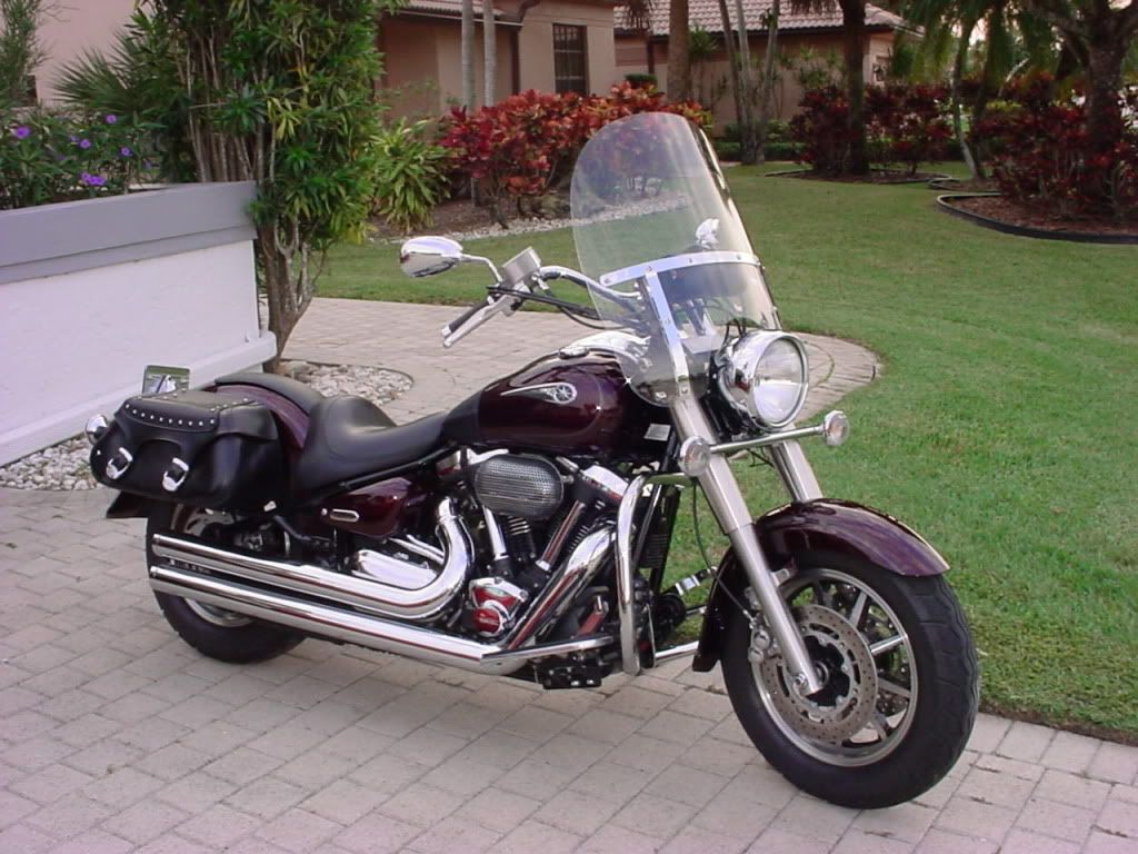

My other biks is also a RoadStar and I will never give that one up.
