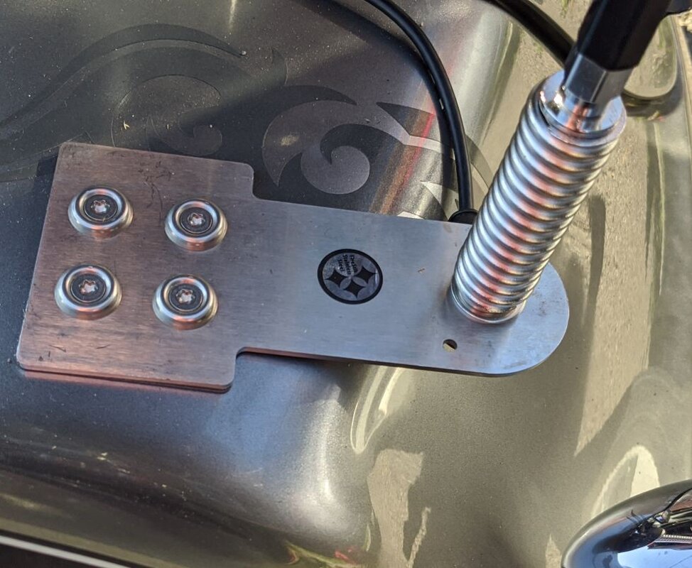

:clapping::good: Update: The J&M CB is installed and operating. The main challenge was mounting and running the coax cable for the antenna. I decided to use a "No Ground Plane" antenna since the body section of this Suzuki trike is all fibreglass construction with no accessible ground connections. Installing this type of antenna required using all the 18' of coax between the antenna and the cb unit. Coiling the coax would cause performance issues with the radio so we used figure 8 loops hidden behind/under the driver seat. The base unit is mounted on the left mirror post with a stainless steel plate designed for this cruiser style bike/trike. This unit included an Aux port for a media player or GPS unit as well as a PTT button for the passenger.
Wanted to add photos, was unable to even following the instructions in "How to Add Photos". It might be that I am using a Chrome book laptop, tried numerous times to upload. If anyone has suggestions on this, they would be greatly appreciated.
Update on J&M CB install
During a week of daily small group rides, this compact CB radio performed flawlessly. I chose the dual unit (also available for driver only) which provides a PTT feature for the passenger as well as the ability to plug in GPS or media player/FM receiver connected to a 48" antenna. The antenna is manually adjustable using the thumb-screw tip. The bigest chalenge was burying the 17 ft of cable safely in cavities under the seats.
Clear reception and reliable broadcast confirmed this as a good choice for a communication system on my Suzuki Boulevard Trike, definitely worth all the effort to install the FireStick no-ground plane antenna. :clapping:
