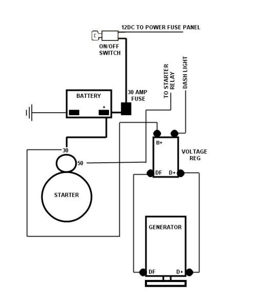

I need a little help wiring a vw generator I got D+ going to the pos on the starter D- to ground I am not sure what to do wit DF?

Since you are building it anyways, I would recommend switching the generator for an alterator. You get rid of voltage regulator also doing that and get more reliable power. Note the alternator would need a dummy light added in line. That is what I did on my VW. Bought mine at appletreeauto.com
If you do replace the Alt or the Gen make sure not to go cheap and buy Bosch. The cheap replacements will leave you sitting beside the road. Unless you are running a lot of high power lights, no need to go to a Alt.... Gens works just fine.

From the looks of the wiring on your project,after frame is painted,I would go with a new VW wiring loom for that year and get rid of all that spliced stuff.VW wiring is simple and would have all the connections you will need for rear and front of your trike.Keep it simple at first and you can add other connections when needed or as you add to the trike.
