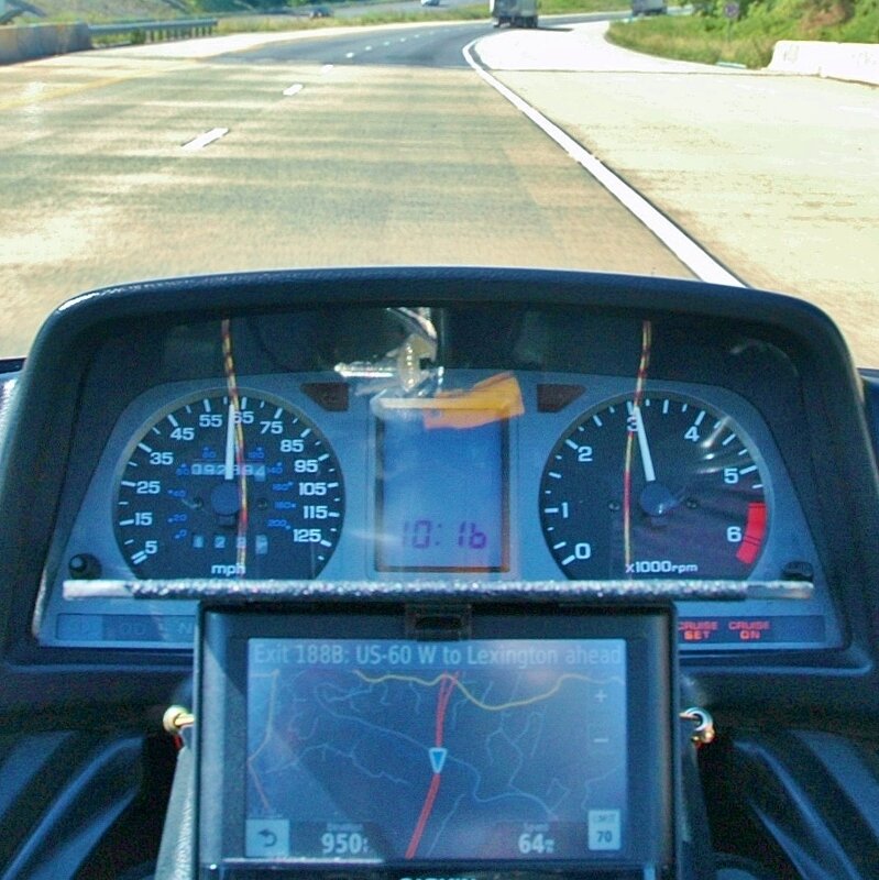

Our GL1500 based Lehman Trike has a 3.08:1 Ford rear gear and uses 215/70-15 rear tires. It came with 245/60-15 tires, near same diameter. Some other trikes I know of have lower ratios like 2.93:1 in the rear axle (maybe not Ford) but use shorter rear tires as well ..... like 215/60-15. If you end up with the engine running 100 or 200 rpm faster at 60-65 mph, that's OK as it just means overall you have slightly more torque multiplication and that'll make it easier for it to pull the added weight of a trike kit plus spin up two large rear flywheels you call "rear tires".
There's always a formula.
Here's a pic of my speedometer / tachometer .... 64 mph is about 3050 rpm in 5th gear with 1/2 worn 215/70-15 rear tires and 3.08 rear gear.a SB 81 Maury 061016.jpg
