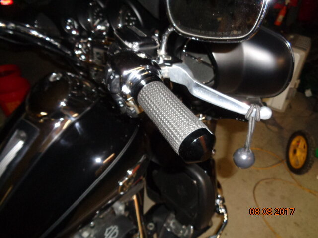

The website is about half functional interesting what is the cost of one of those little gizmos I use a bungie cordDSC00567.JPG
