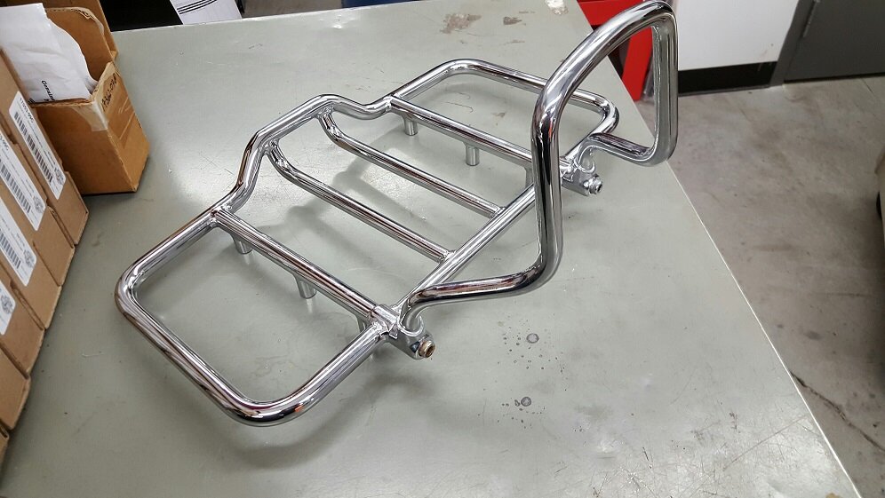

The FLHXXX carrier and sissy bar can easily be mounted on the freewheeler. Just put the FLHXXX carrier and sissy bar on the trunk lid where the freewheeler carrier goes. I cant explain it in writing but if you want to phone me I could explain it to you pretty easy. Doing this would move the sissy bar back about 6 more inches and would look as if it was made for it. I can be reached at 250-558-7705 any time after supper except on Thursdays

Not so sure it would work. At least if you already have the air wing rack like I do, wish it would have. I am also not sure how the trunk lid would handle the weight of the rack, or the pressure from using the back rest. I looked into it a few months ago.....here is a pic of the FLHXXX rack... 20151017_104525_resized.jpg

NPR Harley had one a couple months ago, (that one is in the pic) they may still have it. Just ask if they have the Street Glide Trike rack. Harley does not make them anymore it seems. Talk to Joe Joe if you call he may remember it is the one James or JD was looking at for his blue Freewheeler....

the only difference in weight from the freewheeler rack and the FLHXXX rack would be the weight of the actual sissy bar which is about a pound and a half. I know it will work as I had a FLHXXX rack before I sold it to the Texan. I have a freewheeler now and before I sold the rack I set it on the trunk lid to see how it looked. You might have to add a piece of 1/4 inch aluminum for extra support but that is a simple thing. As for finding one. Go to any Harley shop and ask them to check which dealer has one in stock. If none are available in the states phone any Canadian dealer and they can also check. I know there was one in stock in Kamloops BC, Shipping costs $45 to the states
It might fit and weigh about the same but I would be leery of using this on the FW. I would think that having someone leaning against the backrest plus the side to side stress while riding would not be good for the FW trunk lid, latch, gasket, etc. I would think it would be worse if you had a bag on the rack and a passenger leaning against the backrest. I may be wrong but I just don't think it would be a good idea. Has anyone actually used one on a FW?

I completely agree with Sunman on this topic. The FW's trunk lid is certainly not engineered for that kind of stress. One big crack of the throttle and the wife and lid are gone. ;)

You might be right about the trunk lid not holding if too much pressure was put on it. It could be made to fit but its better to be safe than sorry. Sorry if I got your hopes up. but I am sure someone will come up with a solution to your problem. Best of luck
