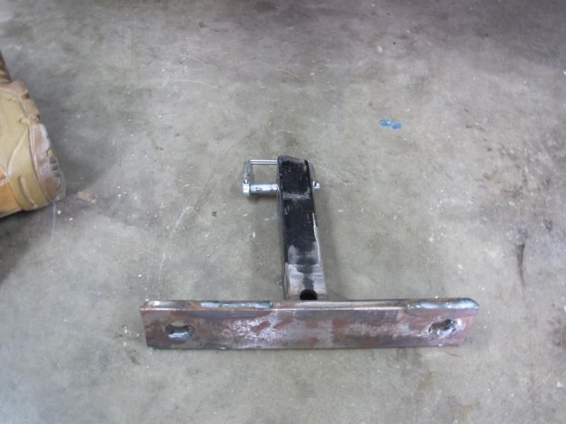

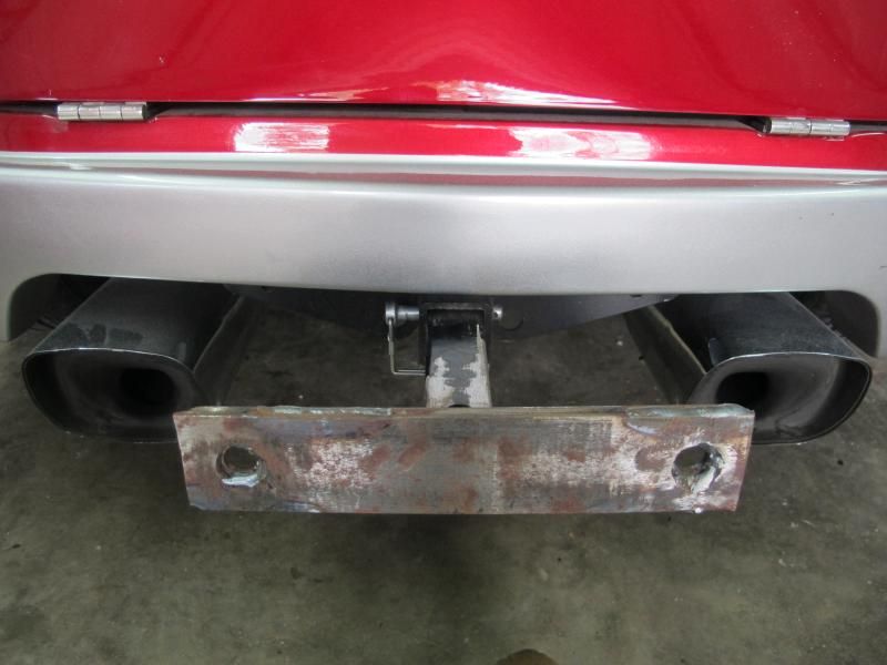

I made a tie down bracket to use with my trike and the trailer hitch.
It is made like a T so I tried it with my bike jack using a 2 x 10 across the jack and it worked great. I can lift both rear tires off the ground .

This is the T I have spoke about: Works great for tie down points and to use it to lift the trike. I will remake the T to a longer Flat bar for more support.
Now this may make more sense now.
