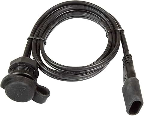

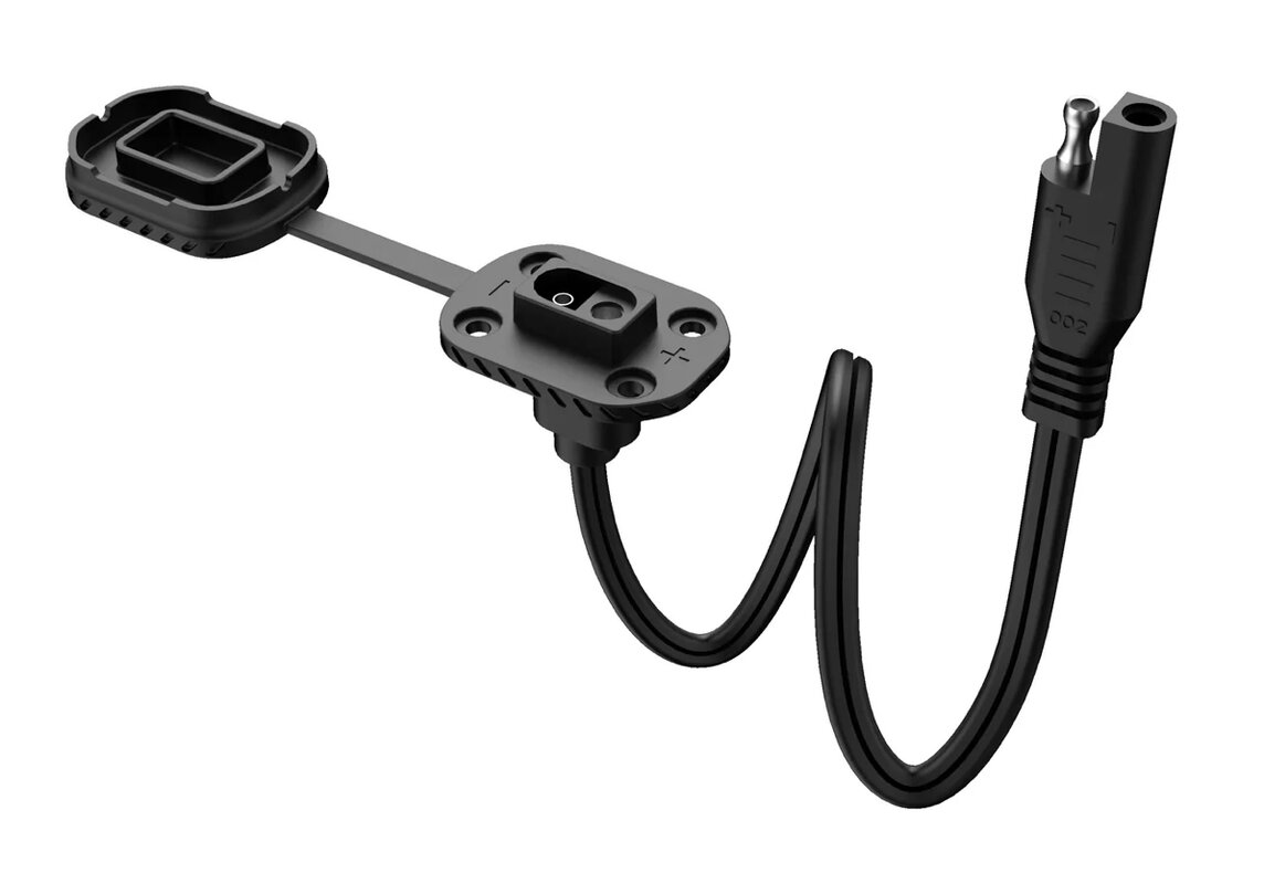

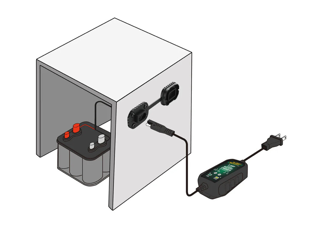

I did see a few other posts not too long ago where a member (or two) purchased an aftermarket one from Amazon and fastened it to the communication port on the LH tour pack speaker pod. I really like that idea!!
The only thing that worries me is possibly cheap wiring causing an issue… (or worse: a fire 🔥). Great chance it would be just fine.
But I decided to order a similar “extension relocation port” made by Deltran (the original Battery Tender manufacturer). Yes, cutting a mounting hole or some sort of bracket will still be required.
I’ll decide where I want to put these once I have a chance over the holidays. I do have two pigtails (one on each side) so we shall see.
I’ll attach a couple pics of the Deltran mount.

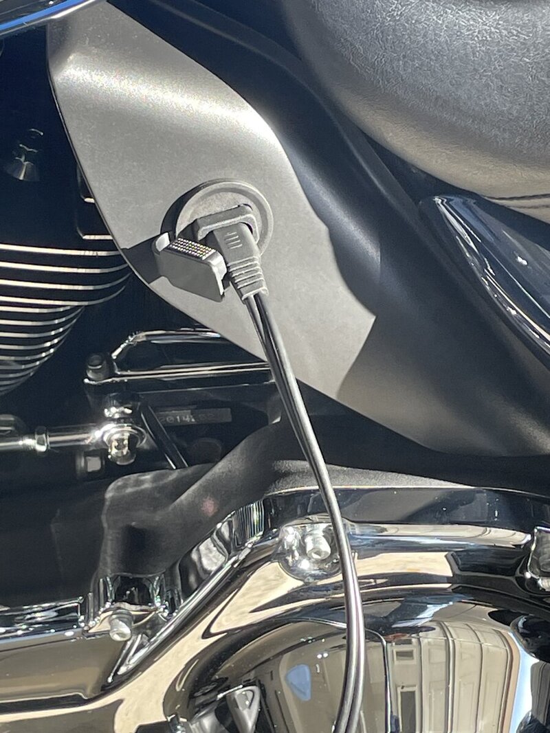

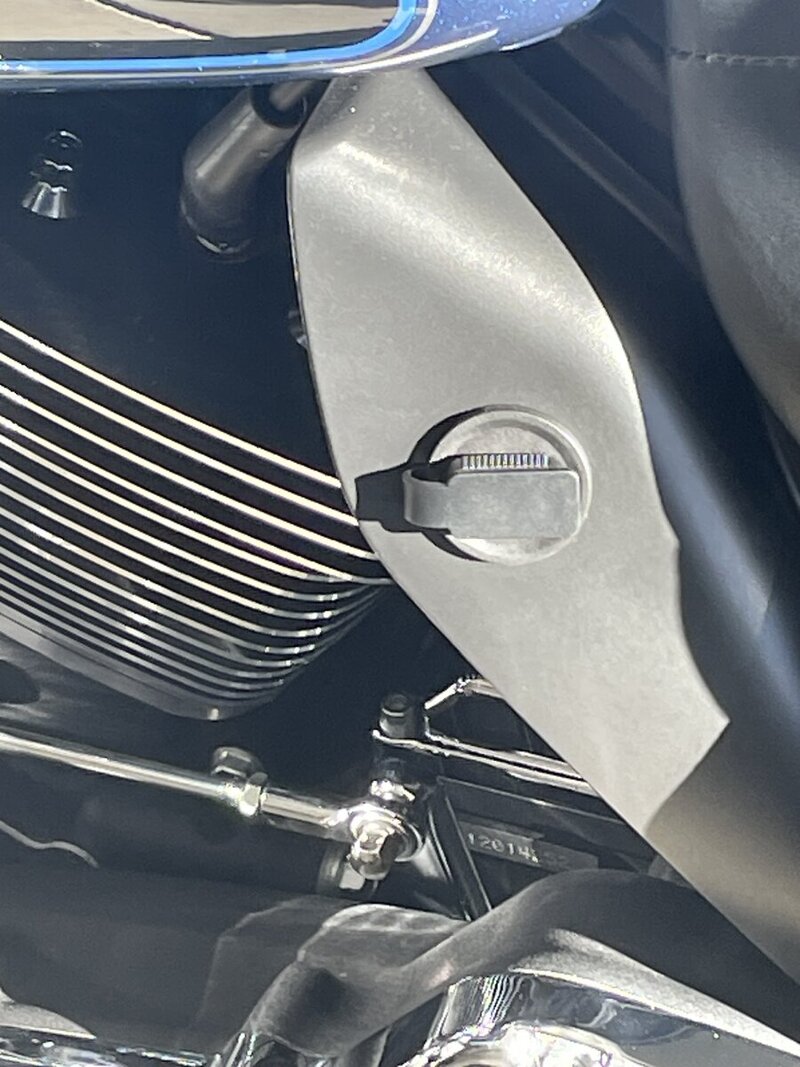

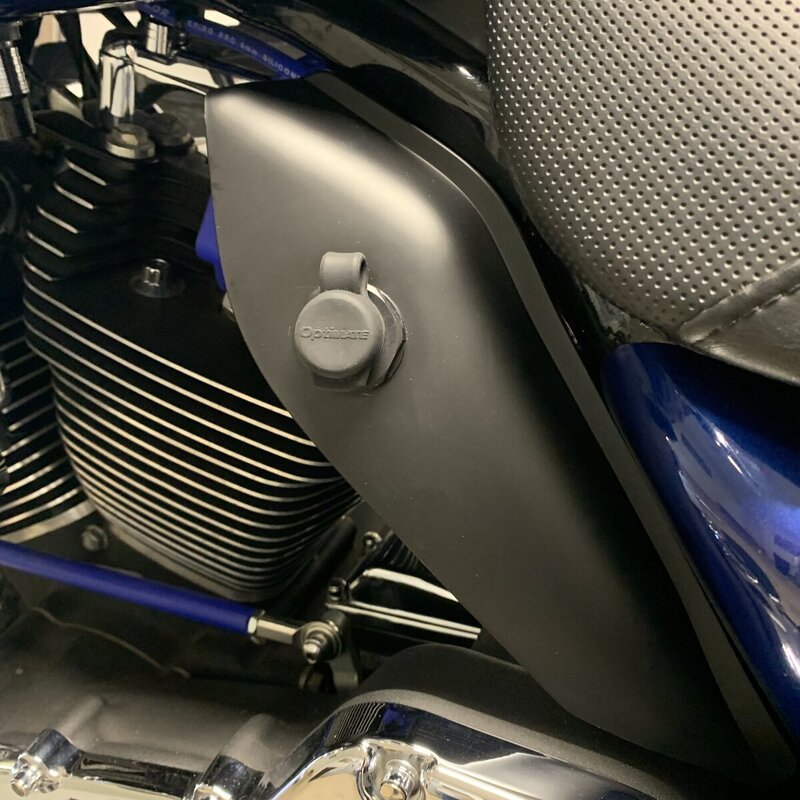

Thanks for the suggestion. I have multiple bikes. I connect a tender to each whenever I'm not riding. I don't want to remove the side cover before and after each ride. (This also wears out the grommets, resulting in a loose fit.) Mid-frame air deflectors are cheap. I might cave and drill a hole in my left deflector and install the cable below. I like the left side deflector because it's further away from the head pipe than the right deflector. I'm surprised Harley doesn't offer a cable mount in the P&A catalog. Then again, if they did offer one, it would likely be chrome plated and priced $150 or more.

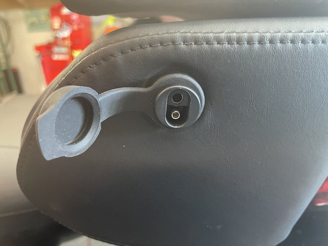

As and example, i have a jump start - jus incase. I also purchased an extension cable and ran it up from the battery and it sort of sits right in the middle of the seat where the backrest goes. You can't see it - and, if needed, you just reach between the seat and pull it up.
With that in mind, you might consider running that extension cable the same way - then, plug in if needed. Whatever route you take, enjoy.

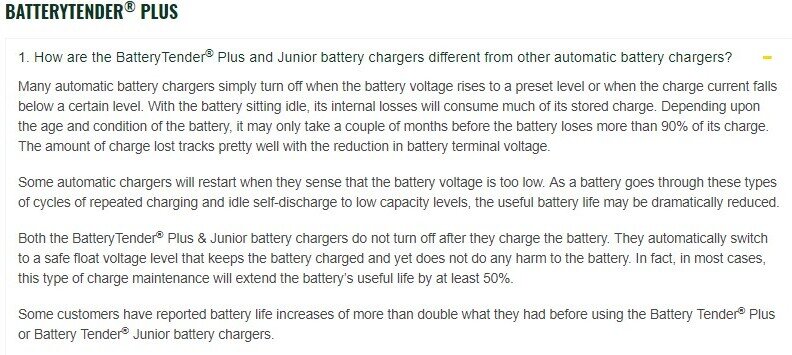

Modern battery tenders are meant to be left on indefinitely and do not cause fires. Invest in a high quality tender, I use only Noco brand tenders and have for years and regularly leave six of them on in rotation in my shop, as does every cycle shop I know of. There is a difference in a battery charger and a battery tender/smart charger. I suspect the fire marshal made that suggestion based on the fact that older chargers use older technology and are not as safe as the newer tenders or smart chargers, and if left on those can overcharge a battery where as the newer ones do not. And as for replacing them every two years, that is nonsense IMHO.
Garage Journal Thread

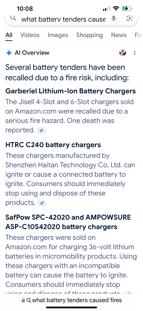

From what I quickly researched, 3 names came up that had been related to fires:
Garberiel, HTRC C240 & SafPow SPC-42020 and AMPOWSURE ASP-C10S42020
(All seem to be made overseas)
Attached is a screenshot.
