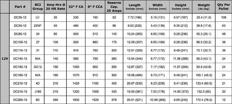

If you have a Battery Box, this might help.
