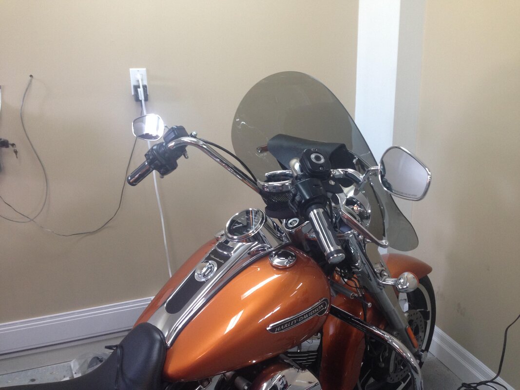

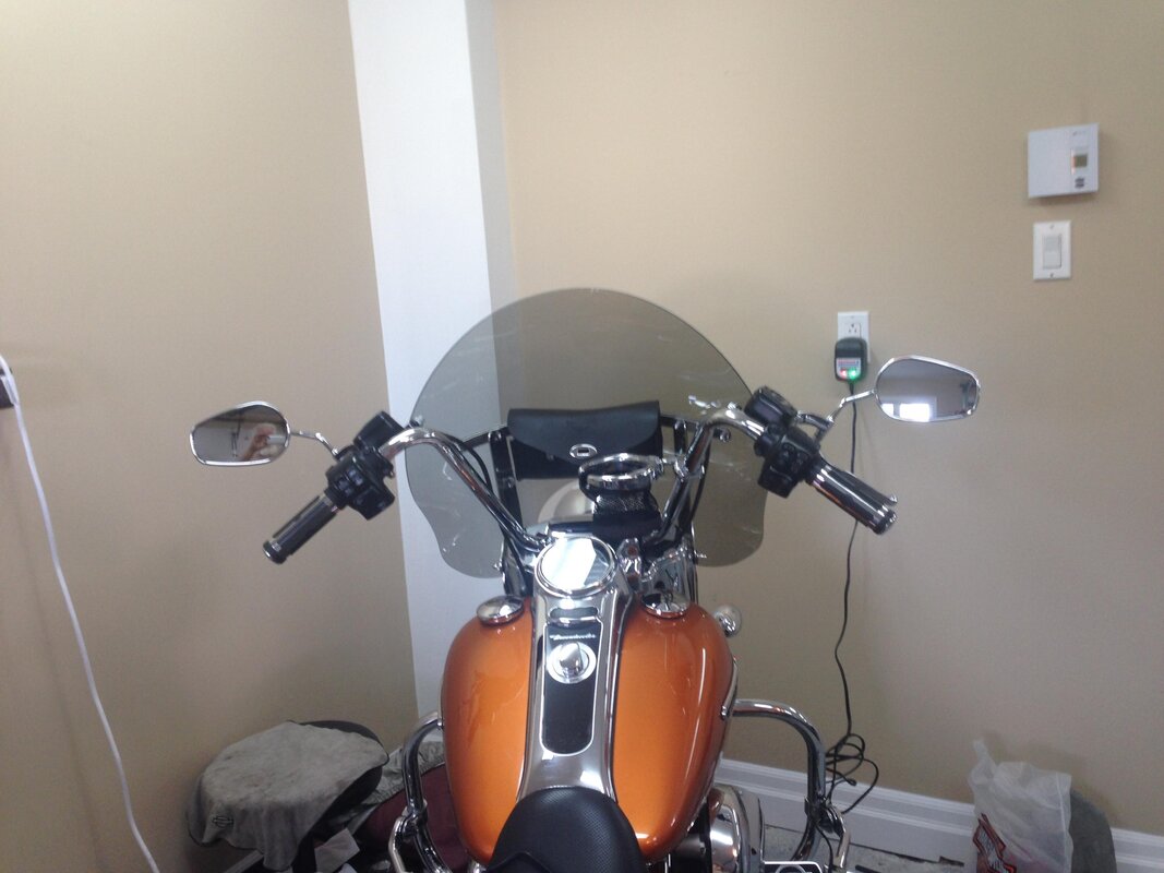

Hey Sunman....bars done, very happy. Will take pics in am and try posting them tomorrow with parts list.
Keep in mind, while they are 16" apes, I'm using them to make up for short arms, so they lean back towards me.

Sunman.....bars had to be modified for throttle controls, took him about 20 mins.
1" ape hangers 16" Kromeworks 0601-1975PR
12" switch wire ext 69200034HDC
clutch cable 37200203HDC
Brakeline 41800439HDC
Brakeline adaptor 41600094HDC
Hope this helps
Doc

View attachment 31194View attachment 31195View attachment 31196

Thanks Doc. Those look pretty good. I will check them out.

just got back from a 150 mi ride. what a difference bars make! sitting up straight arms loose, and the extra 2" width really makes steering easier especially in the twisties! :pepper::D

Doc.... Thanks for all the info & pics. What quick release windshield are you running there? Does it do the job?
Wow...those bars look great!! I wish I could get bars that had that much pullback on my TG. From the side it looks like you only have to reach about half the distance of your tank.
Consitter.....yes, they are great for someone with a short reach. Have a TG in Texas and am hoping to find something for that.
took 2 months to find them for freewheeler, but we have a great dealer here with awesome staff. :clapping::pepper:
