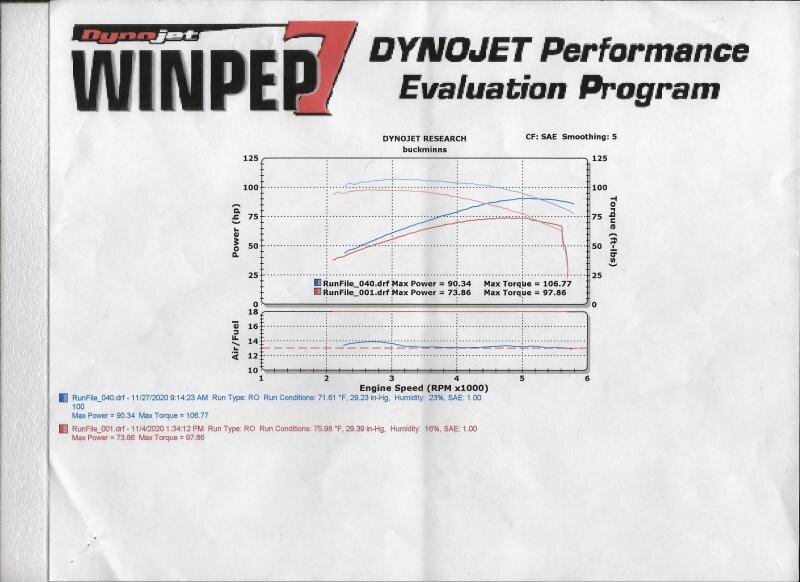

Going to try and post my dyno run so bear with me lol. It's pretty cold today for me anyway so i may bundle up tomorrow and give it a test ride.Pretty happy with the results.On a two wheeler this would be about 100 HP and 116 torque,not to shabby for a cam change and tune.

Low 50's today out i went,wow what a big difference it made 5th gear roll on from 2500 is really nice along with 6th gear roll on from 60-65.All in all very happy so far,its pulls very strong thru every gear was thinking about changing out the mufflers to something with a deeper note,not now plenty loud enough.I may have to upgrade my sound system now.
Hmmm, for some reason I can't open the attachment?
What were the numbers like?
Nevermind, now I got it.
When my 14 was a 110, I think it went 112/106.

I'm running a S&S 465 cam,Fullsac sport head pipe,S&S premium lifters along with the S&S lifter cuffs and a TTS tuner and Screaming Eagle Street Cannon mufflers.
