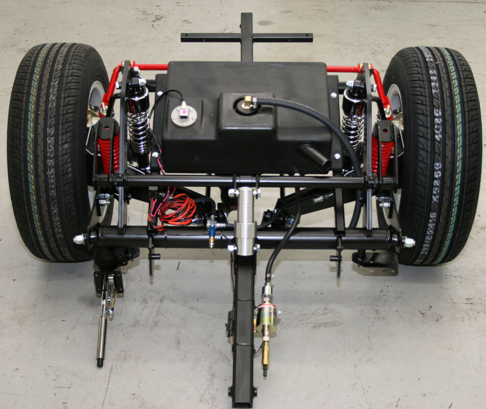

1. 2011 HT1800 kit. Is there a fuel filter on the auxiliary fuel system?
2. Best way to drain tank?
The filter is before the fuel pump. Follow the supply line from the auxiliary tank to the pump. The fuel line goes into the pump first (sequence is filter, pump, one-way valve).
Easiest way to drain tank is to disconnect line from fuel filter and drain into an appropriate container. Might want to have something handy to pinch-off the line if necessary (needle-nose channel locks, etc).
Let me know if any questions!!
Jim

Thanks for the info!
