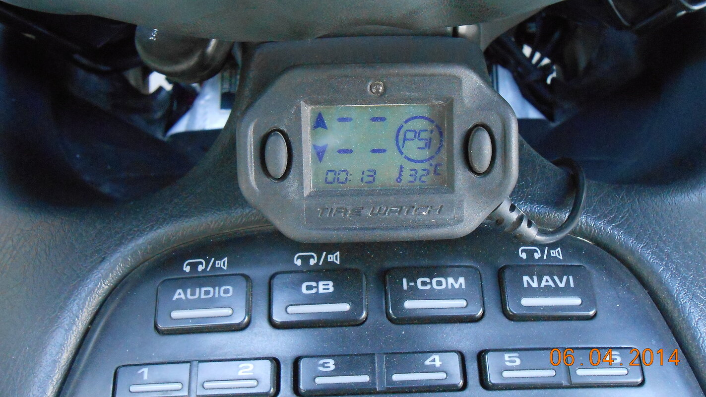

Woolie, the one that came with the rim I purchased from another darksider is a Yokohama Avid Envigor run flat and the size is 195/55-16... The rim is also a TPMS rim so there is a sensor in it as well... MY bike is an 09 and I have TPMS and I also have the pre-production Tire Watch monitor that Fred Harmon of the 1800 riders forum tested, so I get an actual readout in numbers of my tire pressure and tire temperature... This is a great asset as the Tire Watch monitor marries up to the OEM sensors without any registering needed...
The Honda TPMS system's low PSI threshold is around 34PSI so the OEM TPMS system will flash a warning until the tire pressure gets up to 34 PSI... I plan to disable that system and use only the monitor in the photo as the Yokohama tire like to run around 31-32 PSI...

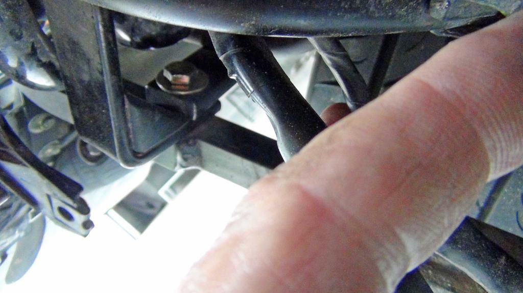

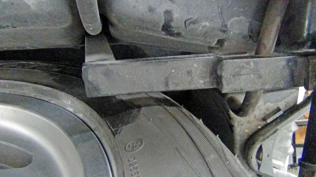

The downside of the Tow Pac, at least on my InstaTrike and 09 GL1800 is you can't install or remove either the stock tire, or a car tire, without disassembling the Tow Pac sub-frame and prying it up for the clearance needed... Here are a few photos of that... This photo shows the Tow Pac bracket that interferes with tire removal

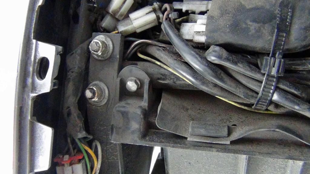

This photo shows the U-bolts that must be loosened and the next photo shows the bolt that must be removed so that you can pry the bracket up for additional clearance to mount the tire...
Tow Pac didn't tell me I wouldn't be able to change the tire without loosening these bolts... It's not a real big deal, but it would have been nice if they said something up front!!! It only adds about 15 minutes of work to the overall project...

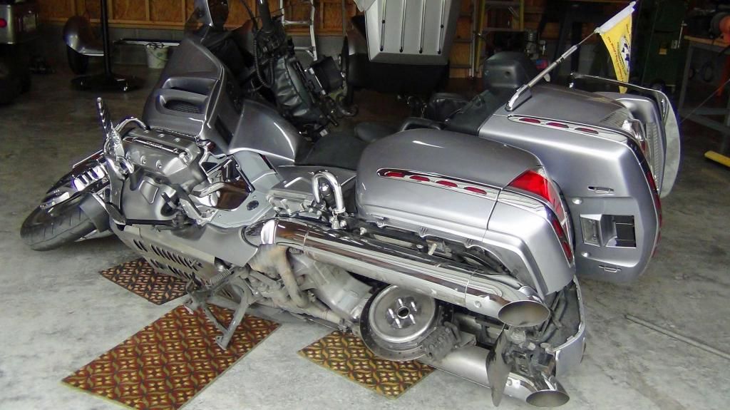

I used the "tip the bike over on it's side" method for changing the tire even though I have a drive on Handy Lift - it's just easier to do it this way... You can see the Centramatic Balancer on the rear wheel hub of the bike, and I just installed Centramatics on the Tow Pac as well...

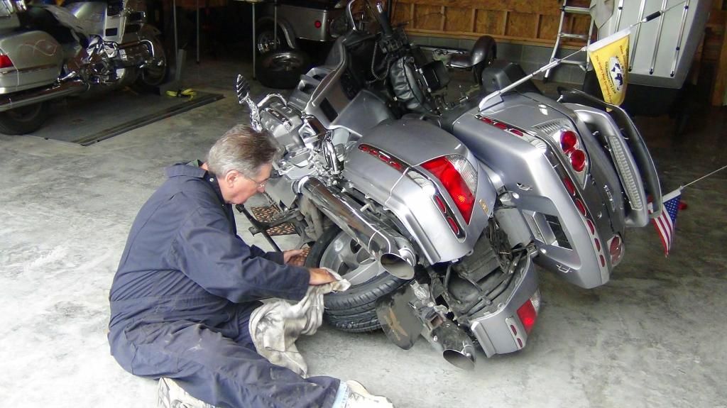

And no - I don't own two Goldwings - that's my buddies bike sitting on the Handy Lift in the left of the photo of me cleaning my rim... You can see in this photo that I removed the rear fender cover to gain access to the necessary Tow Pac sub-frame bolts...
