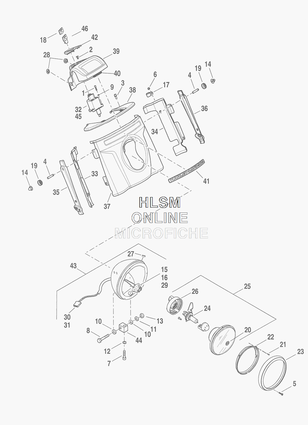

Adjusting headlight on Freewheeler
How do you get to the bolt to adjust light front, rear or bottom
Ya got to look at the front end ahead of the gas tank, U will see the bolts thru the block, they are 3/8 inch= 9/16th wrench, Pretty stinkin tight
Now the one goes thru left to right that is 4 uo and down
The 1 thru the bottom { Straight up} u can get it from the front of the bike, cover ur fender so ya dont ding the paint
This bolt IF u get it loose U can swing the light bucket L and R
Look at #44 here
