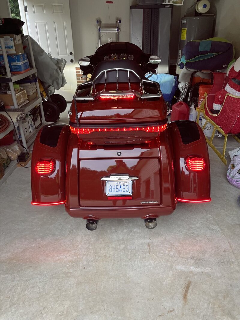

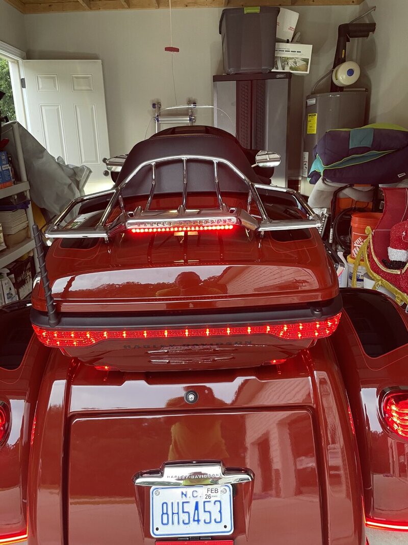

Hello all, hope everyone is doing well. Today I put on the HD Airwing rack with the Custom Dynamics LED for it on my 24 Tri Glide Ultra. Install was not bad at all and by no means am I a mechanic or anything. Figure it adds a little storage and protects the paint a little.

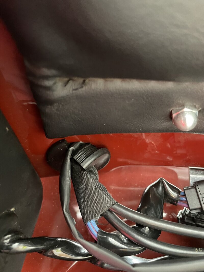

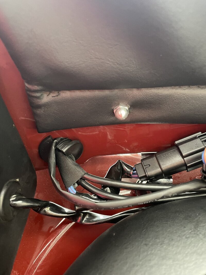

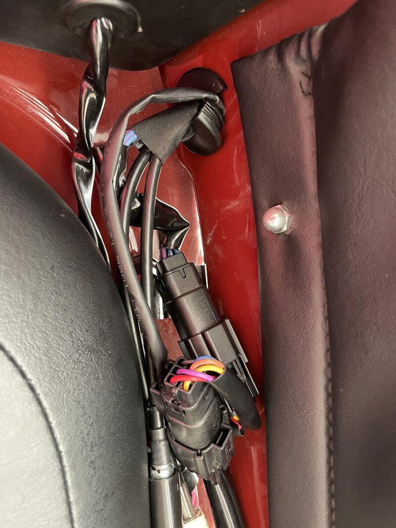

I have a 24, the wiring is under the flap just behind where the rear of the seat ends. There is a rubber grommet in the corner of the tour pac that comes out and you run the wire thru it. With the Custom Dynamics light, it’s all plug and play right there. I’ll post a picture tomorrow.
