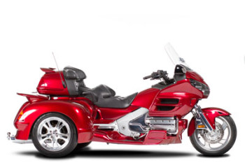

Pic ofshort wheel base
Note the front of the rear fender is even with the riders seat back
Pic of long(extended wheel base:
Front of fender approx even with passenger seat
