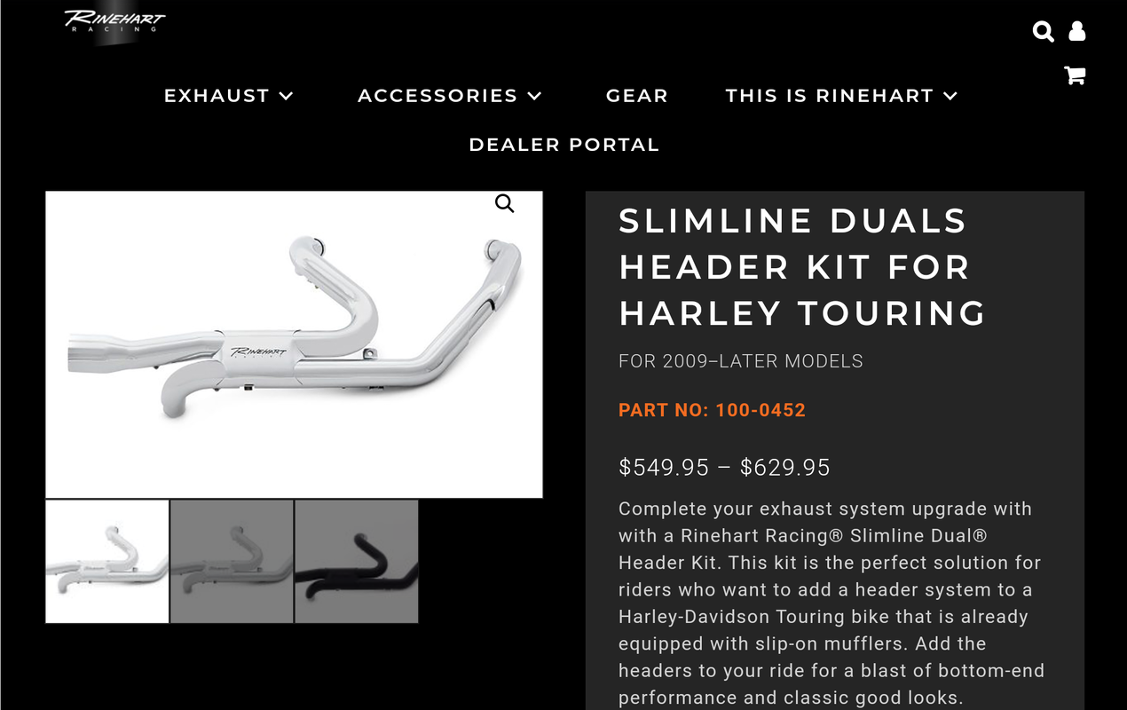

Has anyone had any success with the SE Pro Street Tuner with a full exhaust system like the Rinehart Slim Line Duals? I understand the Warranty Issue, just interested if anyone has tried the SEPST with full exhaust on an otherwise stock 114. Thanks
Are you talking about Rinehart's Racing Slimline Dual Header Kit, P/N 100-0452 for 2017-later. If so, I believe Tri Glide and Freewheeler installation also requires an additional Slimline Duals Trike Conversion Kit, P/N, 100-0480 for 2017-later.
Not sure how many may have chosen this particular path for headers, especially if they're not an approved item by MOCO and available through the HD Parts System. The installation would surely void their warranty, whether the install used the SE Pro Street Tuner or not.
If had to guess what the moco's position would be....the word "Racing" in Rinehart's description would be the nail in the warranty coffin decision. Of course, I could be way off base with my thinking too.:blush:
An update to my previous post after talking to my HD Parts Manager.
• First the "Racing" reference to the headers description doesn't apply. Found out that's actually the company's full name, "Rinehart Racing".
• Parts Manager says, since the Catalytic Converters are in the OEM exhaust system, any removal of the stock headers automatically voids the warranty, no matter who does the installation.
I do like these headers and really like that you have a choice of using two different sizes of 02 exhaust ports, a 12mm or 18mm. So one can choose which works best for their particular configuration. The smaller slim design is also a more pleasing look to me. Warranty would not be an issue on my 2016 Tri Glide. If only my ship would come in...SOON!:laugh:
