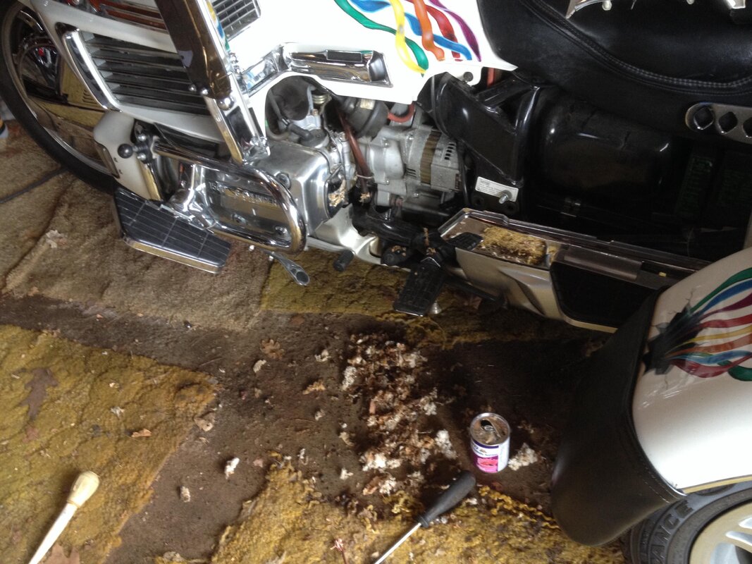

Had it happen last year 1997 wing
pulling long hills two up in 85 deg temp saw gage hit just shy of red. Down hill or over 50 on flat it cooled down to normal or below. Stopped at a gas station. Add 1/2 a slurpy cup of water 6 oz and no problem the rest of the day. Not much water in that bike so a few ounces is a big % of cooling power. Yes keep eyes on radiator bugs and vermin building nests.
the little Fu.. Buggers only too 2 weeks to build it. Fast little Sh suckers
