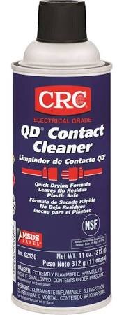

FLOOD it with contact cleaner while working the switch. Should start it working again. Wouldn't hurt to do ALL Switches while you are at it .
Thanks to all for the advice, I'll get some CRC contact cleaner and see if I can get it to work.
I have used spray silicone instead of contact cleaner very successfully. The issue is not with the contacts themselves it is the funky grease Honda uses which turns into more like glue. A few drops of spray silicone in the proper place works wonders. The problem is that the actual switch is WAY BACK IN THERE!!! If it were close to the opening the whole process would be easy.
