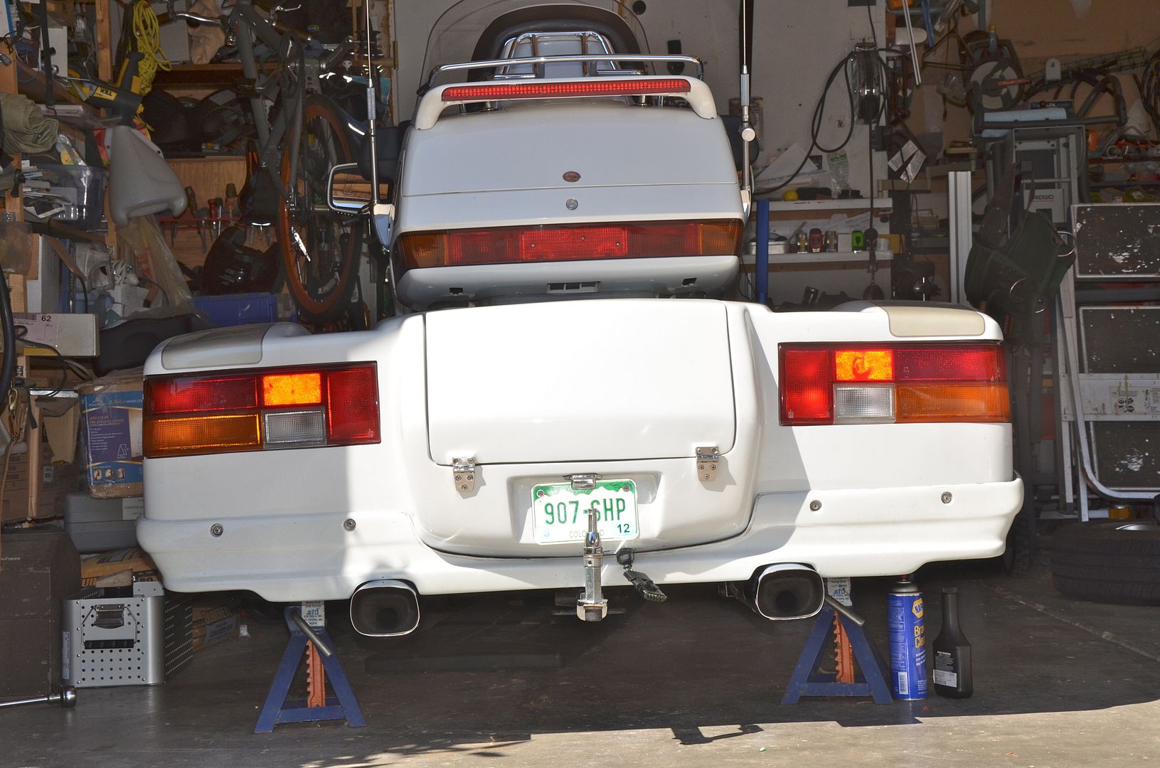

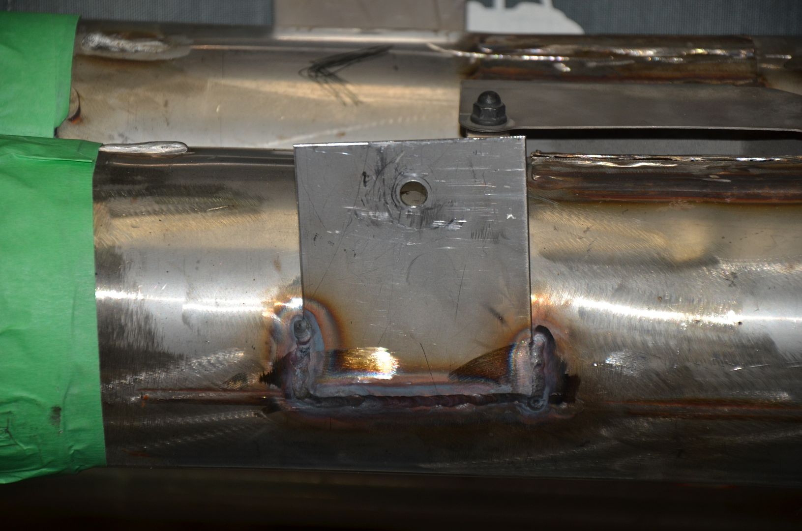

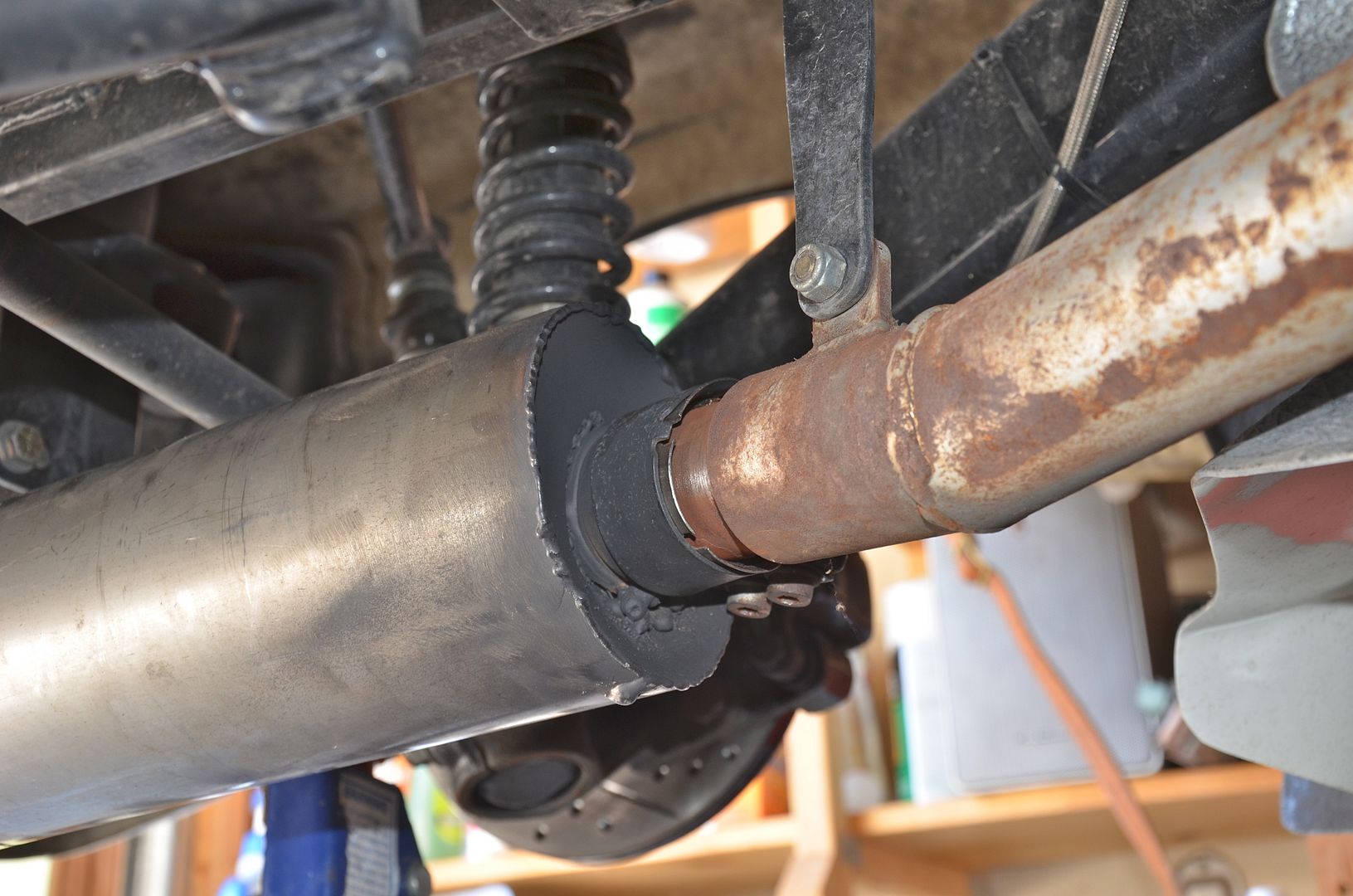

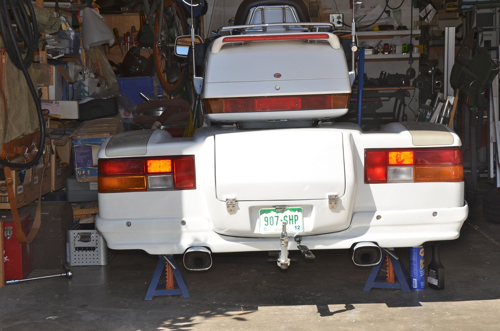

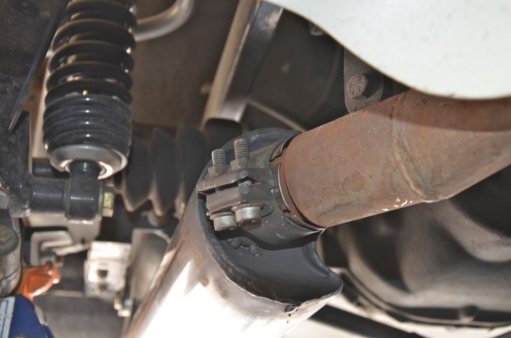

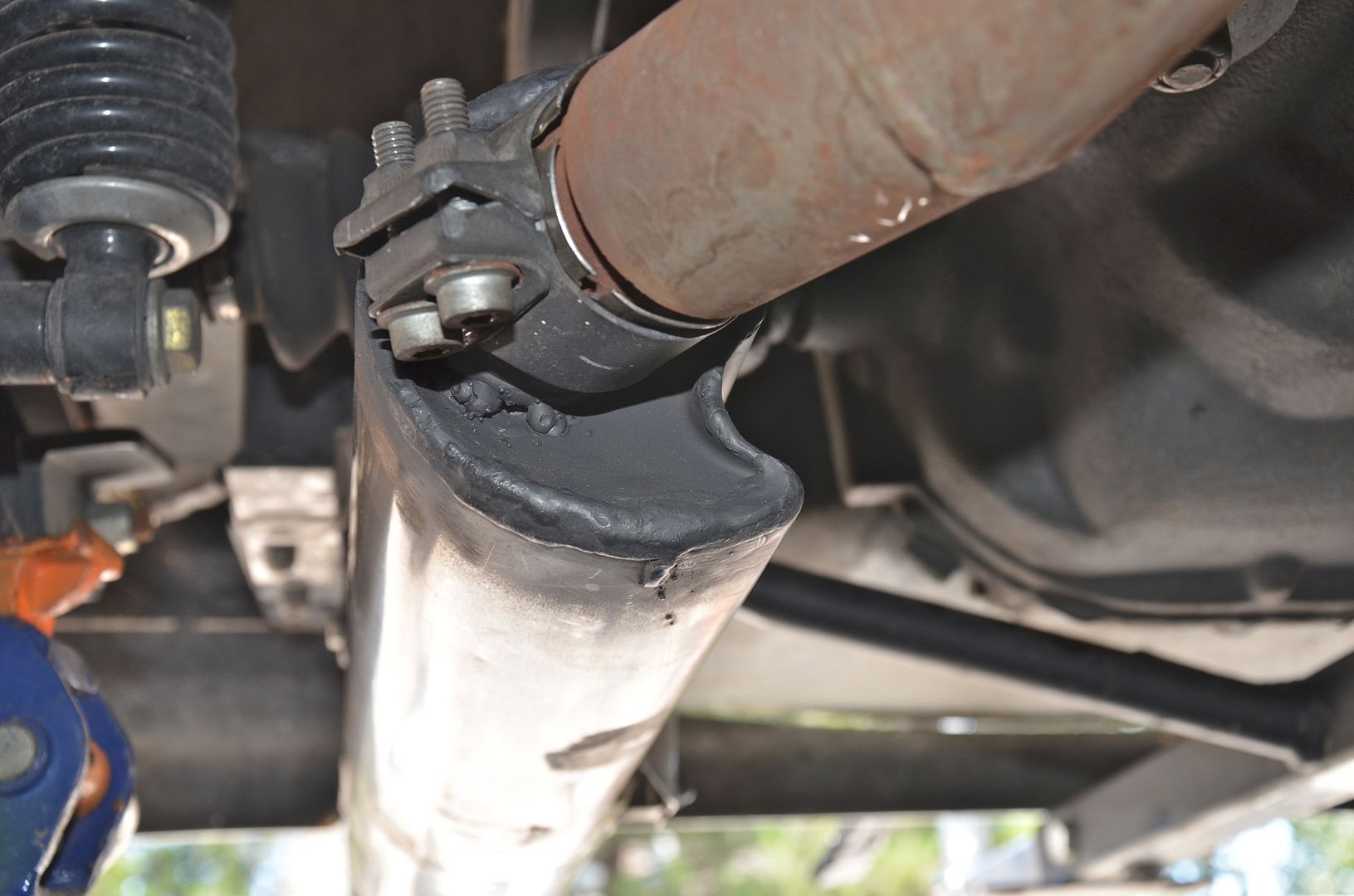

It is possible to put the 1800 mufflers on a 1500 trike and make them fit and look correct. You must do some cutting and welding but it can be done by the owner even if you do not own a welding machine. If anyone is interested I will pots the info and pics of how to do it,

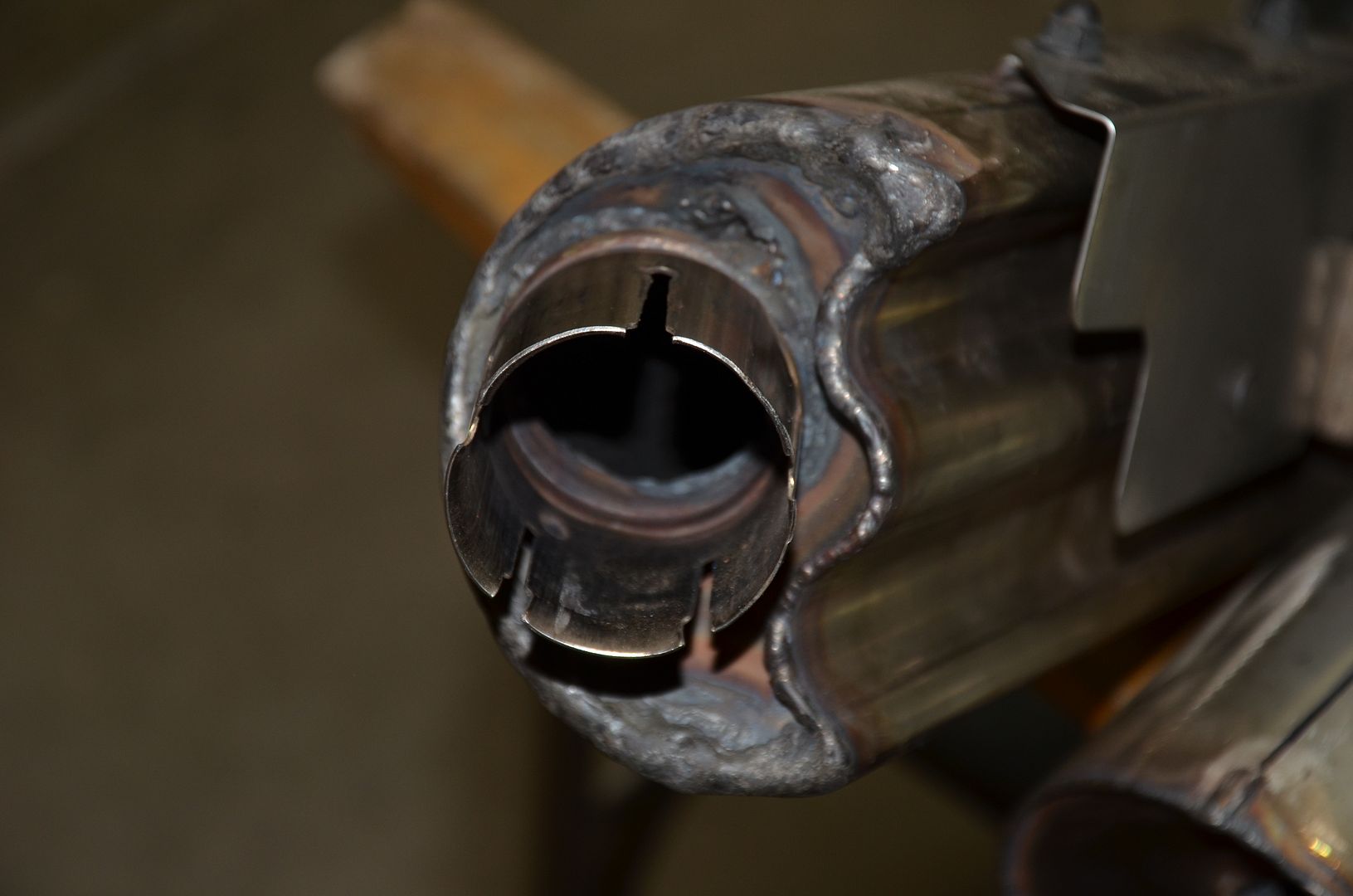

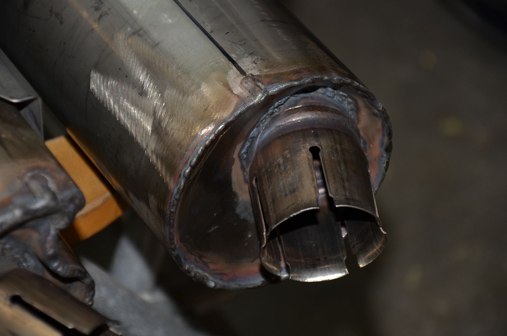

Those bad TAC weld will be ground off this winter. The inlets are welded on the inside before the end cap was welded on the case.
