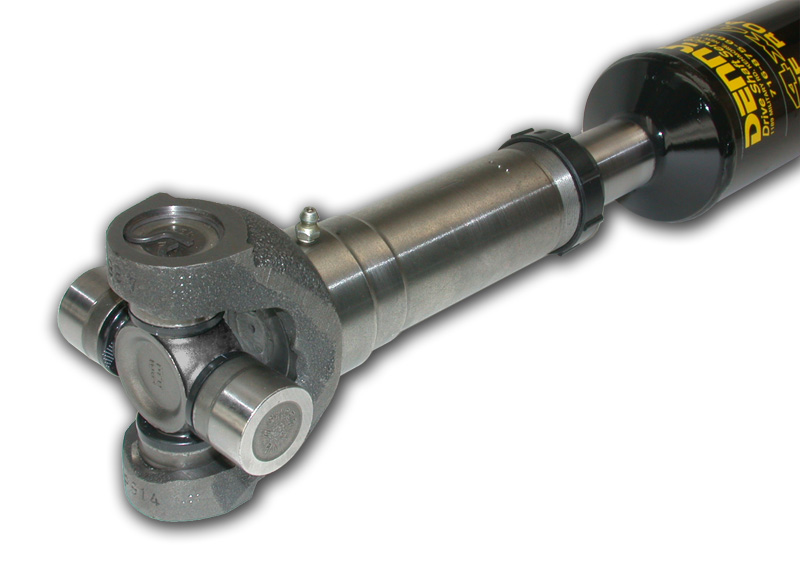

Your shafts probably have slip yokes on them
That would explain the zerks
the slip yokes slide on splines so the axles can move when the bike rolls over bumps in the road
The grease will provide the lube for the splines
Here is a picture of a slip yoke ( note where the zerk is)
You are real close Jack. :clapping: The splined slip joint is there but it's sole purpose is to facilitate driveshaft installation and removal. Once in place and adjusted properly the Roadsmith slip joint is secured with a collar making it semi fixed. The Zert fitting does allow for greasing the splines without removing the drive shaft.

Thanks Jerry
This ole dog learned some thing new today;)
Thank you, as I just learned something myself.... Ok I just squirted a couple of shots of grease in the zirks, before putting her away for the winter season..
Cool beans!
thanks again,
Ronnie
