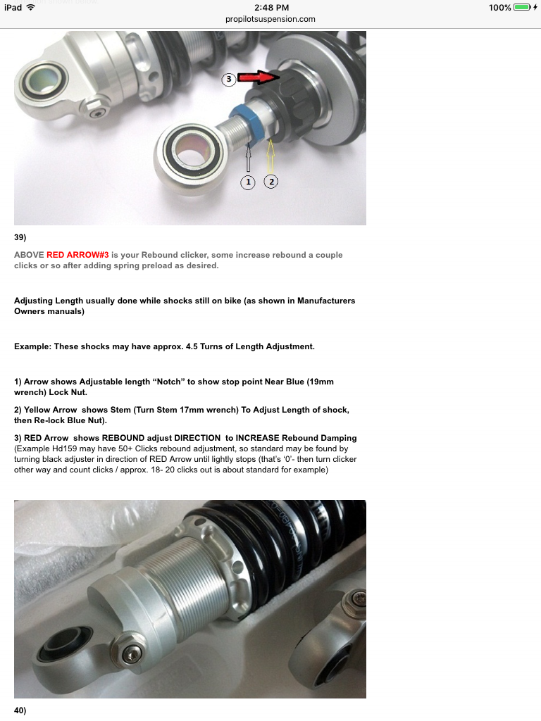

I put the Ohlin HD 159 Shocks on My 16 TG, They are adjustable in length and fit great
so far they are performing much better than the stock ones, dialed them out 23 clicks for my weight, they come pre adjusted image.png
