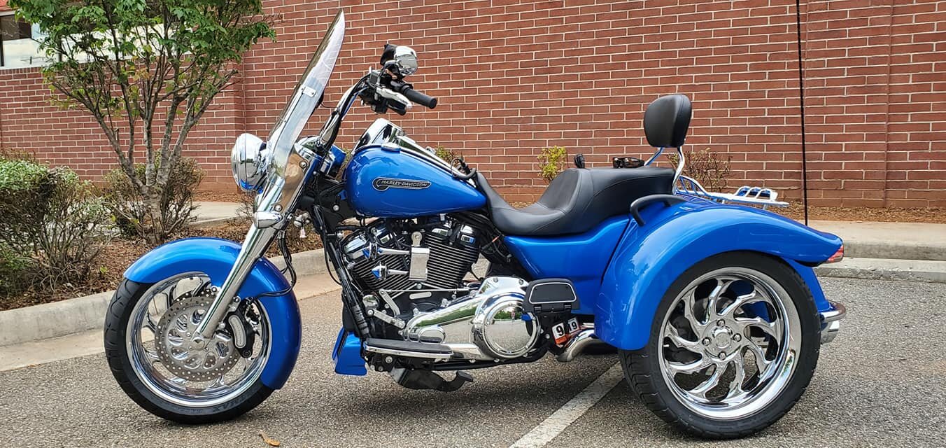

Finally got the it together. Native Fat Front tire Kit with Mods to work on a trike 180/55/18 front tire PM wheels front 18x5 rears 18x5, Tank Lift. Gotta keep Mama happy. Just wanted to show her off abit. Next order a windshield shorter windshield. Got to install the pass floorboard covers tomorrow and clean her up, got caught in the rain on the 60mile test ride.

Yes it is the trike Air Wing Rack. I have the Fat tire also on my Road Glide in 12k miles I've been caught in rain a few times, it hasn't acted any different than the stock tire, thou I haven't been in a gully washer with it yet. I rode it yesterday "freewheeler" in a light rain when we picked it up and the roads were wet and I pushed it alittle and didn't have any confidence issues with it.
That is a beautiful machine. I love the front end treatment. How does it ride with the 18" rear wheels? Is it noticeably stiffer with the shorter sidewalls?
I run around 22psi in the shocks (for her when she is solo) and have 35 psi in the tires. *they were a bear to seat and mount*. I think it is pretty much the same from what little I have ridden it. She hasn't told me that we need to adjust anything but she hasn't done a lot of mileage yet with it. She is still feeling it out. We have a trip this week so she should have a better feel for it the next couple of day and we can tweak the pressures if needed.

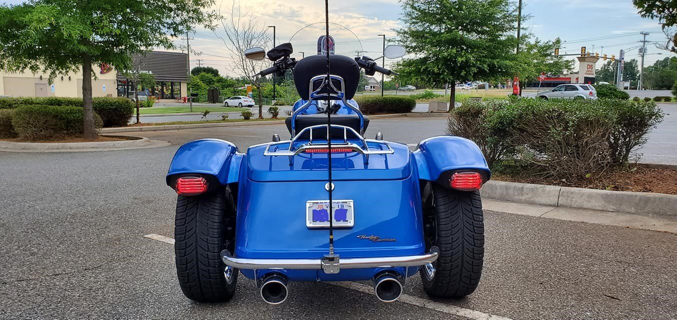

Your bike really looks nice. I would be interested in the license plate in center of trunk. Did yours come like that or is it a mod you did yourself. I have been thinking about that change on my freewheeler. Any advise.

18 Wheeler..... Can you share how the ride is with the fatty, did it reduce front end bounce losing the 19" low profile tire that was stock?
To me it planted the front end, as it doesn't feel light in the corners anymore. The wife said it was alittle heavier to turn in a parking lot, but no steering difference at speed. she has about 3k miles on it and loves it.
Thanks in advance
I made a stainless steel plate with a 3/4in tall square spacer in the center to keep it off the body. I used a lay back softtail license plate fender mount as a mockup to make mine. 3 bolts through the body, 1 drilled out the center of one of the bolt to run the wires through for the lighted plate frame. Bought a right side taillight mount and it bolted on the left fender to replace the one with the plate mount from the factory. I have some pic somewhere if the plate I made I think.
Thank you Sir.... exactly what I was hoping to hear. And I am assuming prob a smoother ride at speed due to the tire config vs the low profile...
I believe it is smoother, I run 40 in the front. Its the Dunlop dual tread compound rear touring tire running backwards so hopefully it will last about along as the rears. I have the Native kit on my Road Glide and that's what pressure I have found works the best for handling and performance. I can tell you that it doesn't react nearly as bad or at all to grooved roads or normal pot holes in the highways. Unfortually she is a newer rider with nothing to really judge it against, she only did about 2k miles on it before we started the kit install so its hard for her to convey what she thinks would make it better for her.

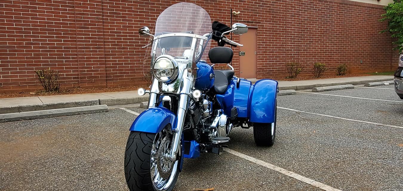

We have the Comfort lift on her freewheeler also, haven't done the coil overs yet. I ran the Dunlop dual tread compound on my RGU and only got 10k out of the front. the soft sides were almost slick but the center was fine and I could feel the transition from the hard tread to the soft tread compounds in corning, it almost felt like it fell over when it transitioned. So far the Dunlop on the front of the Free is wearing very slowly with 3k on it, no visible difference between the center and sides. I switched front and rear to the Night Dragon GT bias ply on my RGU, I have about 10k on them now and they are wearing slowly and uniformed and handle better I believe than the Dunlop's.
When we mocked up the cowbells and fender on her freewheeler. Native was just doing a feeler if they would sell it when I finally got the kit. In fact I talked to them 3 different times over 6 month and twice they didn't have trike forks or interest in producing a kit. Finally they had 2 sets of raw forks on the shelf and I ordered one knowing we would have a lot of fit up to do to make it work. We gave Native the dimensions on the cutout in the cowbell to lower it since the forks legs are longer than the touring line.
I went with the OG Fender, The fender was for the touring line also. the mounts on the touring forks and trike forks are slightly different. I cutout the rear side and added a piece to the front even the gap around the fork and slotted the rear bolt holes a little to give some camber adjustment to even the gap of the fender around the tire. Originally the cutout around the fork leg was almost touching the rear of the fork leg and there was a 1/4in gap on the front side. about 3.5months on the rack at my dealer, working with me to get it on with fit up, modify, fit up tweek, paint, chrome, final install.
Both my bikes were the first in the area with the fat front ends. So it was a learning experience for both of us. hopefully Native has done the back ground on the trike and made this a bolt on kit for the trikes with out having to mock up like I did. Funny thing is that her Freewheeler gets more attention than my Road Glide, even when they are parked side by side hahaha.
One other thing is with the 6 piston caliper. You have to leave the front rotors loose on the rim to get everything installed on the forks when installing or removing the wheel. there is not enough room between the fender, rim, etc to pull the larger 6piston calipers off/on unless the rotors are loose. kinda a PITA installing but worth it. the smaller 4pistion calipers on the 19 up trike will probably not be a problem mounting.

The 180 front tire most definitely made the trike ride much smoother.. The moment I left the garage one could feel the difference. If your thinking about it, I recommend it.
The mufflers are stock Freewheeler cans that I had American Custom modify.. I liked the fit and look of them vs the aftermarket ones that stick out past the body and the bumper with some. The wife doesn't like it nasty loud so it has the baffle inserts.
