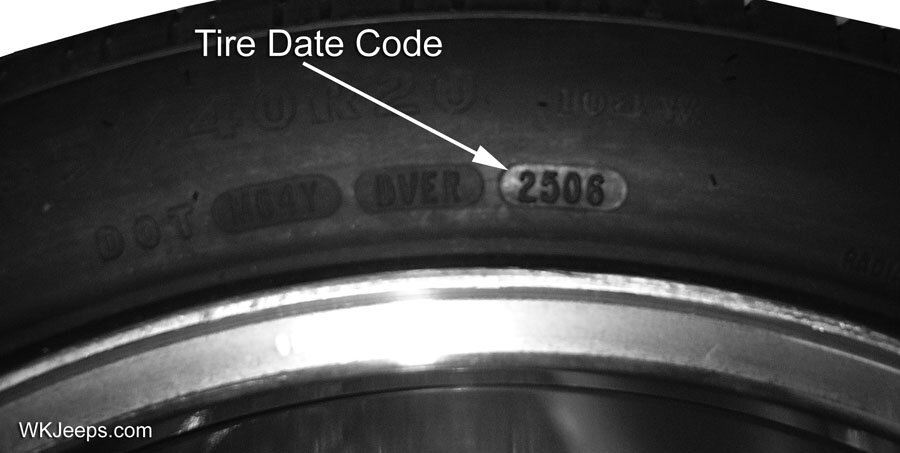

Look for this marking to see when the tires were made.
The one below was made on the 25th week of 2006.
