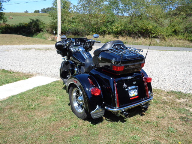

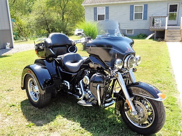

Lifted Mine
Here are a pics of ours with Lift kit we did not level tourpak. Maybe sometime in future plan on that Mod.ThumbUp enjoy the ride fearless

Did the DK comfort lift and tank lift with deluxe option. Have not touched the tour pak. The Sweetie has a back issue from an auto accident, and it took sitting on many bikes before buying the first Harley 07 ultra classic. The tour pak fits her back perfect and I don't want to mess things up. Jim

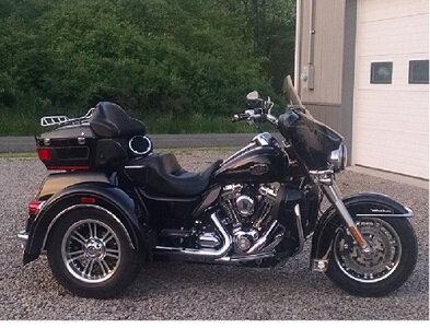

The newer models look more level for one, or possibly 2 reasons.
1. The Tour-Pak is not only a different shape, but the rack it sits on is angled so the Tour-Pak sits parallel with the ground, not parallel with the top of the trunk. You can see it in the photo below-
This goes a long way to make it look like the tail end of the TG is not drooping..because the TP is more level.
Fact is that the actual frame, trunk and exhaust are still just as low on the 14-16's as previous years.
2. A lot of dealers are putting Comfort Lifts or Standards Lifts on their Tri-Glides & Freewheelers before they even hit the floor for sale. It is very possible that yours may already have a Lift Kit on it, installed by the dealer.
