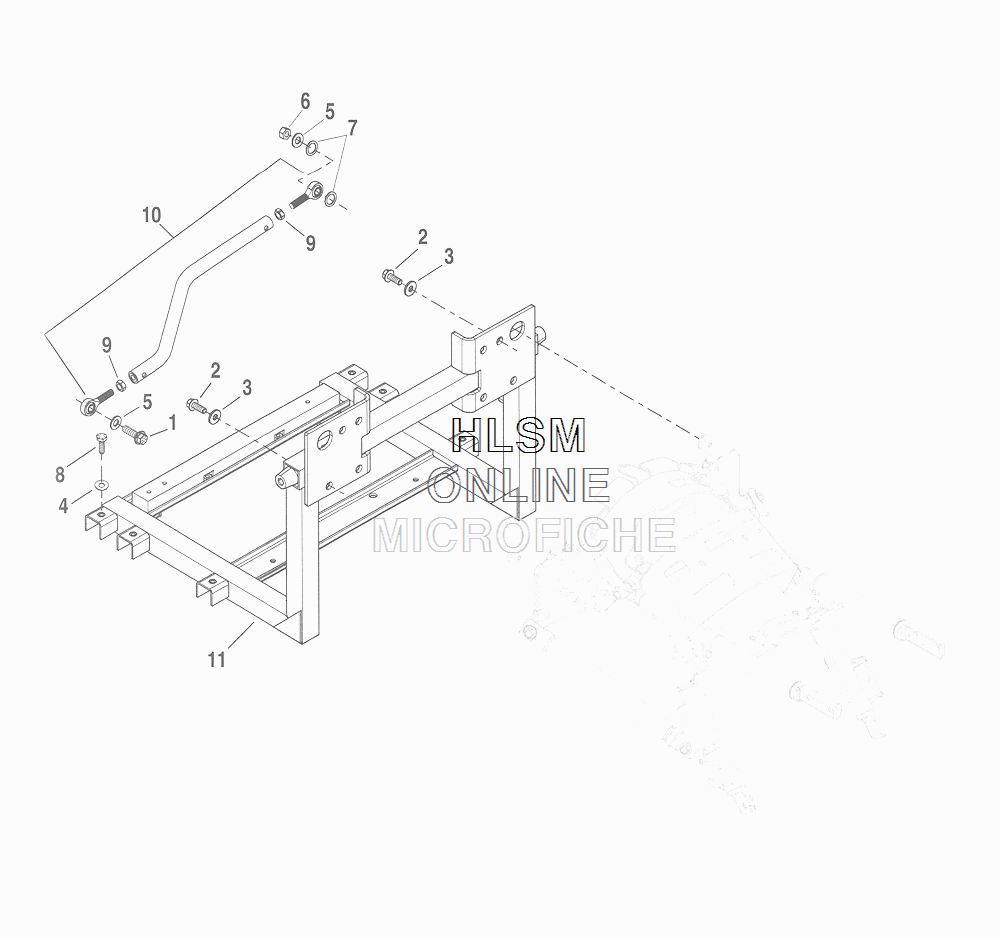

Also have a look at the panhard rod, if the joints are worn you can have tracking issues
# 10 in the picture
