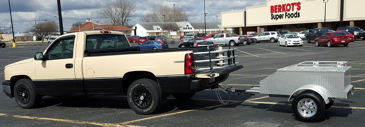

Trailer followed me home
Great looking trailer! Will hold a lot of eggs.
Sunman
If I'm not home on Easter Sunday it will have to hold more than eggs! It was funny pulling it home, I had to drop the tailgate so I could see the trailer...too funny
And Thanks.....jc
