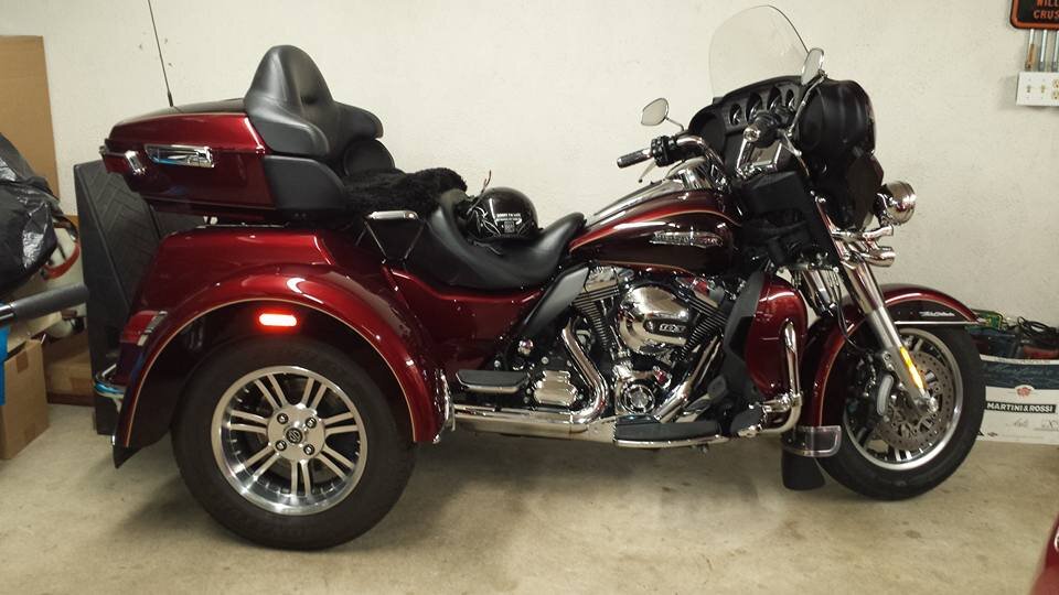

2014 - We rode for over 1 year and 10K+ miles on a stock system. We got used to the heat.
Finally I de-catted the stock head pipes (you can purchase from www.wildpigpipes.com for a very reasonable cost.).
I use Nightrider FL-Vied-10 fuel enrichers on my oxygen sensor lines. (set at 62.5%)
I still have the stock mufflers since we like listening to music while riding.
My trike "Roxy" sounds louder, runs way cooler, .... and we are happy for a very low cost. We now have over 22k miles on our trike and get 36-38 mpg. It keeps running better with more miles on it!!!
The stock Rushmore A/C flows plenty of air for a normal rider. No issues when it rains (no rain cover required for an open element).
If your end goal is to hot rod the trike .... then don't go my route.
If you just want a more comfortable ride with a bit more pep ... then consider my cheap options .... which work great for us.
Enjoy the ride!
Bob :D

Wow. There were so many questions but I finally decided on my Stage 1 A/C. I went with the Outlaw 606 with an External Breather System. Some of the things I learned during this decision were:-
1. There are so many to choose from. The first step should be to narrow the search down to a couple and then decide from there.
2. Consider which A/C cover you want to go with and make sure the A/C will fit inside it. Some air cleaners come with their own covers so the OEM one can be changed out for something different.
3. Consider how much further out the A/C cover will sit after the new system is installed. Will it be in the way while riding?
4. Consider getting an External Breather System so that hot, oily air does not get routed back into the engine anymore. There are a few choices to be made here too.
I'm sure there is more but these points are what comes to mind.
I would like to send a Huge shout out to Kevin at DK Customs. He was so patient and kind to answer a million PMs and even called me to make sure I was getting the right system for me. Great customer service. Thanks again Kevin. :clapping:
I should receive my A/C in a few days. When I get it I will call and make an appointment at my dealer to get it installed. I will update this thread with how that goes.
First step done.
