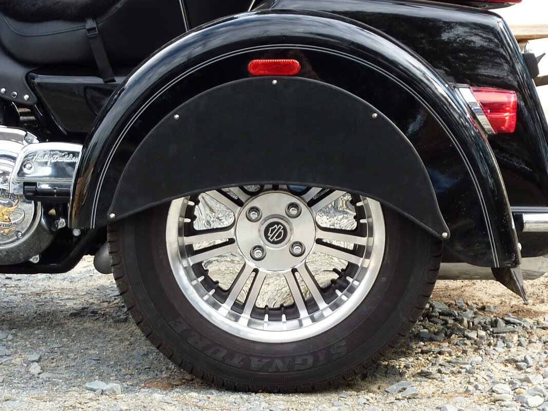

I found my Motortrike rear tires were rubbing on the inside of the tire. I added a 1/4" wheel spacer to eliminate the problem.
I now run P205/65R15 same size as the Triglide. I did add a 1/2" spacer to set the wheels outward for the stance.
The reason I went to the different size rear tire was the availability to get the P225 /60R15 is not stocked at all tire shops if I would happen to have need for a tire replacement on the road.
A problem might come from running a low tire pressure & pulling the tire over in a turn also. If there are worn bushings in the Tri Glide swing arm or bad ends in the pan hard rod you could have movement sideways.
I don't know how much slack is built into the IRS systems, but there are definitely more places to wear.
This is why I wouldn't go to a wider wheel than 6". Also the clearance for the 205/65R15 tire is correct under the Harley fender.
If a person wants to widen out the fender (lots of work) then wider tires & wheels are possible. People have put 7" wheels under the stock fender & say they have no problems. I don't think they have had them in some really hard corners above the posted speeds ! LOL ! There could be enough tire flex to get into trouble with that wide of a wheel.
Realizing I know Jack about tire deflection in hard turns.....but I thought the deflection is on the lower part of the tire?
There is more deflection at the bottom where the road is pulling on the tire, but the center of the tire remains pulled sideways by the wheel throughout the rotation of the unit.
The higher pressure in the tire the less deflection because the tire sidewall becomes stiffer.
If the tire is pulled sideways say 1" at the bottom depending on the speed of rotation & pressure, the top could easily remain at 1/2" to possibly 3/4", & still maintain a bead seal.
