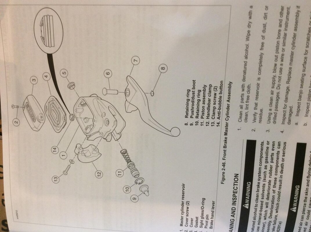

My right brake handle has a little play, but I noticed it's squeaking a bit. Thoughts or ideas?

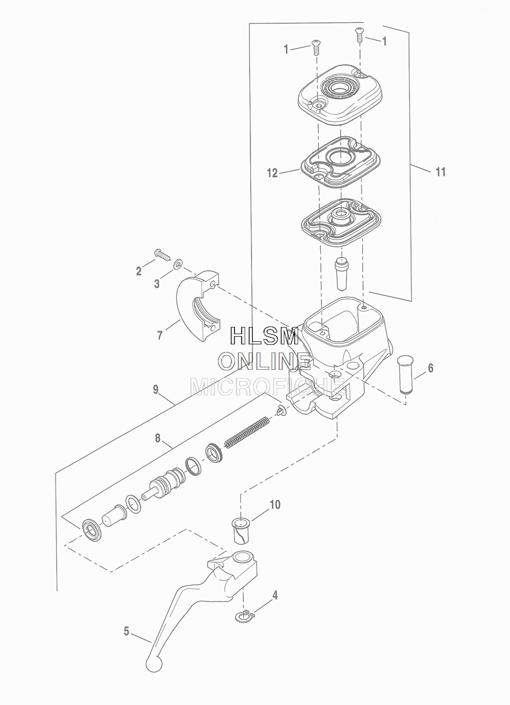

Look at #10, it is a bushing for your lever (both levers have 1)
Over time they do wear, the levers both need a bit of slop thru the bushings, or they would bind or snap off. Use some spray lube each oil change, and put a dab of white grease in the front of the lever, it is kind of tricky, I use a long swab.

I guess I never knew the brake master cylinder had a cable.
Push rod/dust boot
It was the pushrod/dustboot. Number 9.
Sprayed some silicone lubricant up there. Right as rain 😎👍👊
