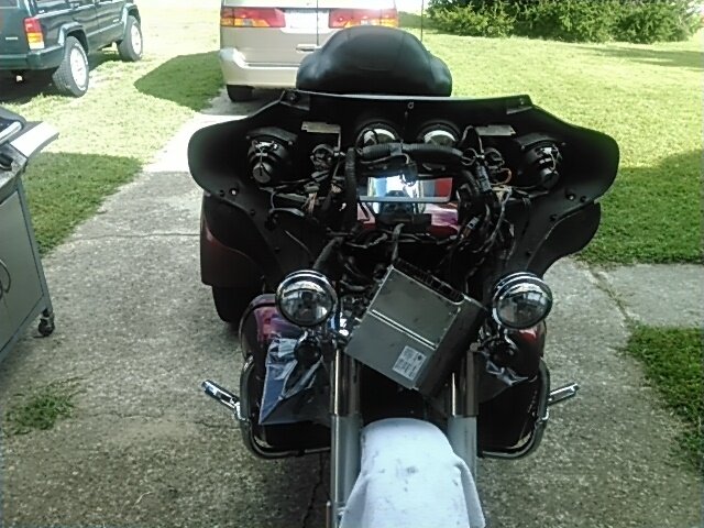

Photo finally
Clutch cable
Did the 2+2's require any cable extensions, longer cables, etc? That's my next project, and I'm just trying to figure everything out cost wise.
Thanks, and nice trikes![/QUOTE ]
Needed a 3" longer clutch cable I have the number if you need it. remember old shiney is 09 vintage not hyd. clutch all other brake lines wiring I had lots of extra to get the length. The only tools I needed to get were Ball End Allen wrenches for radio removal. you really should have a shop manual to do this, unless you have experience at such activities. Remember Harley's come apart in layers starting from exhaust because you are changing clutch cable, 2+2 wide sweepers have worked out great for me. Bar fit is individual to each doing it yourself should be under $250. easily. Having it done expect $400 up. :Shrug: need any thing let me know fearless

It's not hard work just take your time hardest part was Clutch cable for me. with the manual it is easy. Biggest things it gives all torque values Utube videos really help. fearless
LRS is two minutes it takes longer to get the tools and put away than it does to change windshield.

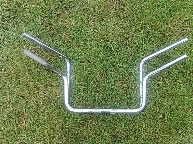

Here are the 2+2s I put on my 2010 a couple of weeks ago. Longest ride so far was 250 miles and no problems. I'm also 5'8". Since they come further back, they give you more steering leverage. Fearless calls them "power steering".
if they are the 2+2 wide sweepers from Chrome works, then that is what I am going for (hopefully) and all you need extra is the (extended wires?)
2+2 bars
TBEAR, the bars on my RED trike are the narrow Khrome Werks 2+2 sweeper handlebars (#300519). They are about 1" wider than the stock bars. The wide sweeper bars (#300517) are about 4" wider than stock, On Fearless' black bike.
I see that you also have a 2010. We both had to put on extended clutch cables to make it reach. Not needed on the 2014 and up trike, I believe.
The picture shows the narrow 2+2's along with the stock bars. You can see the width and height, but the sweepback doesn't show up from this angle.

You will need a 3" longer clutch cable all wires and brake hoses are long enough. What is nuts to change clutch cable the mufflers, header pipe,foot board all have to come off not hard but it takes time. :Shrug:ride safely fearless
