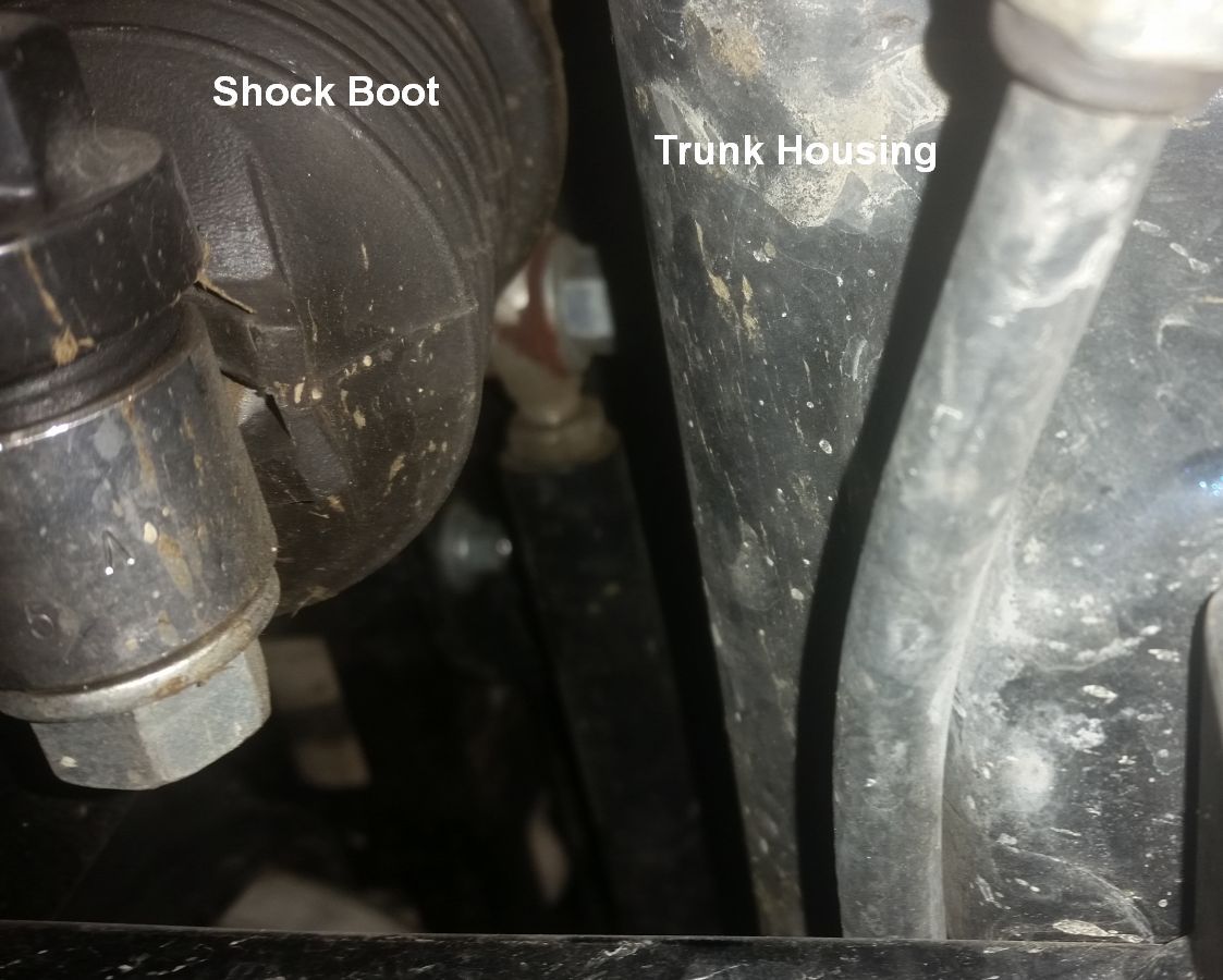

I just went out and took a couple of pics of the dirty underside of my TG. The first one shows the shock boot and about a 1/2" distance between it and the trunk housing.

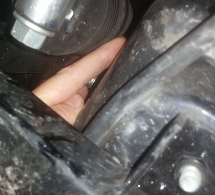

The second pic shows the shock boot and the trunk housing with my finger in-between the two.
Look to see if that space is equal/very close to equal between the two sides. That will likely tell us if there is a mis-matched set of brackets installed or not.
In either case, please contact us.

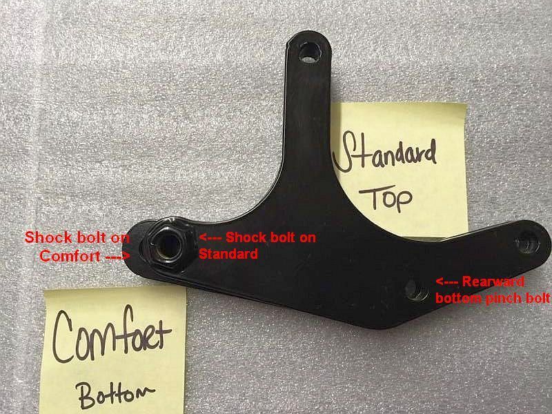

I would not use the exhaust to hold up the swingarm, use a jack instead. Below is a pic of the difference between the two. Also, Devin pointed out the best way to see the difference between the Standard and the Comfort is to measure from the center of the lower shock bolt, to the center of rearward/bottom pinch bolt.
If you have a matched pair, they will be the same. The comfort lift is about 1/2 inch longer.
