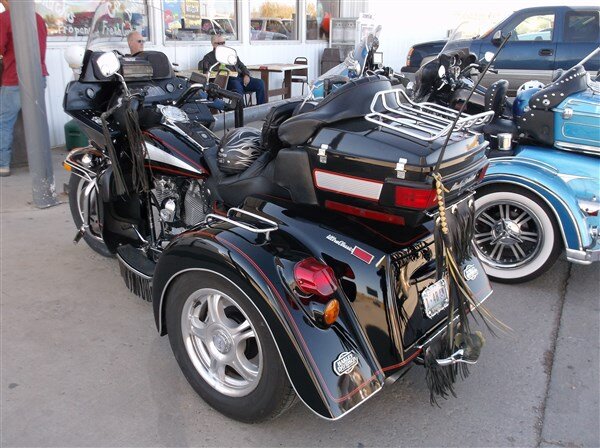

Just bought a Harley conversion trike with no reverse put on it, this is my first trike ( 07 ultra classic conversion ) I was looking at the MMD one because of the 1000$. Most others are 1400 and up .. Trying to get some info and your thoughts. Do ppl ride trikes with no reverse?
I rode without for several years. Its all about planning your parking. When necessary it pushed easily.

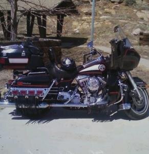

This coming from a guy who has kept the same bike for 27 yrs. and built his own trike.
Quite often the problems associated with building one piecemeal will turn out to be more expensive than a full conversion and will keep you off the road and out of the wind for a far longer time than you can afford with your present health conditions and Yes I do know of wich I speak ok?

I used the solid axle kit from Champion trikes and they do offer a reverse, I didn't put one on mine. it's to easy to roll around.( I do pay some attention as to where I park) I used a hog halter 9 degree overall rake on the front end, I didn't need a park brake either. All of this I bought through Bazooka who is this forums owner for a fraction of the retail costs associated with most builds.
