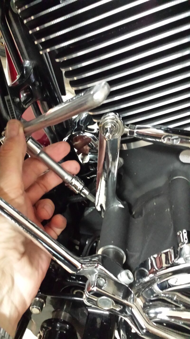

Have them put loctite or lock washers on all your pinch bolts. My bet is the inner bolt is loosening up.
