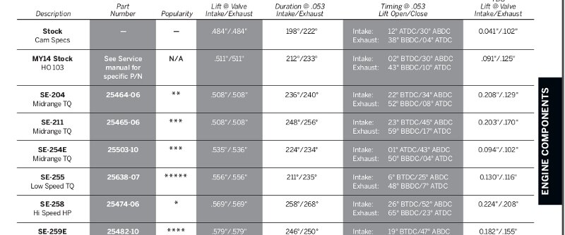

Can't seem to find any info on the cam specifications on my new 2015 Triglide. I would like to know lift duration, intake and exhaust timing. I know they warmed up the cam a little bit for the Mt Rushmore, and can't find specs any where. Not thinking

Thanks for the help with cam specifications. Harley mechanics tell me that the Mt Rushmore used a cam like the se255's but warmed up a bit. Sure would like to know what they did. I am guessing maybe a little bit different intake and closing on the intake side. Maybe some day the info will be available.

My mech.., one I actually trust, said the 2015 free comes with the SE254E cams which is a mid rage power cam.
But guessing would not the tri have the same cams?
I set mine up for mid power. Stage one, performance baffles and dyno tune. The mid range is very good and pulls good. Pulls front tire in the first 3 gears if that means anything.

The 14's and 15' have the same cam, the spec for the 2014 and later cam is in the screen shot I posted above.

The specifications for the 2014 and later cam is in the screen shot I posted above.
