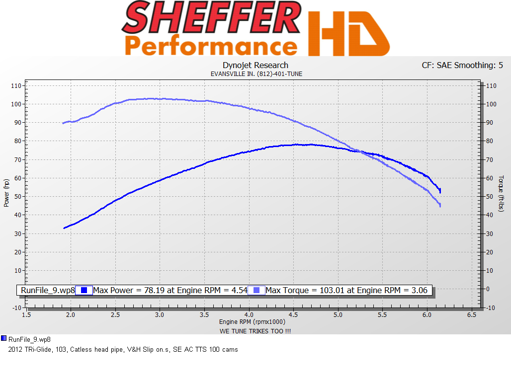

Those TTS100 cams come on nice and early. I bet you're enjoying those!
Sheffer has a good reputation for Dyno Tuning, we have quite a few Customers that have used them and been real happy.
That said, it seems to me your torque is a bit low for having those cams, pretty sure they should be giving you more than that.
He seemed to think my mufflers hurt the results but iam happy with it .
Please notice that the torque is nice and flat between 2500 and 3500. Thats where you should learn to ride. Most power for the least throttle. I run mine right at 2500 to 2800 using the correct gear for that and I get 35+ and as high as 38 MPG. Plus I have all that torque there right away if I need it. Thats what makes those cams nice in our trikes.
What do they charge per hour?
I think he has a flat rate per tune and if he does anything else its extra.
Ithink you should call and talk to him he is very helpful and will discuss all options.
